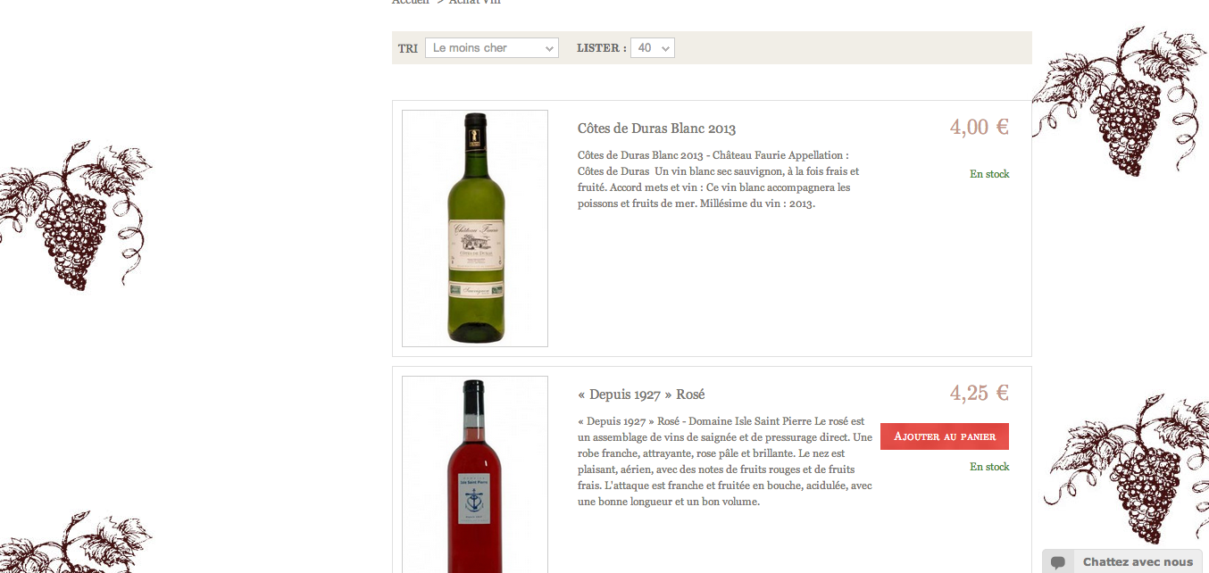

gjarrosson Posted March 2, 2014 Share Posted March 2, 2014 [english version below] Bonjour, Sur ma page de liste de produits, le boutton 'ajouter au panier' n'apparait que lorsque ma quantité minimale pour le produit est 1. Lorsque la quantité minimale est 6, le bouton 'ajouter au panier' n'apparait pas. Vous pouvez voir une exemple ici : http://www.levindefrance.com/41-achat-vin Auriez-vous une indication sur la façon de modifier cela ? Merci beaucoup d'avance, Gabriel Hi, On the product list page, the ‘add to cart’ button only appears when the quantity for the product is 1. When I have a minimum quantity of 6, the ‘add to cart’ button doesn’t appear. You can see an exemple here : http://www.levindefrance.com/41-achat-vin Would you have any indication on how I can change that ? Thanks a lot in advance, Gabriel Link to comment Share on other sites More sharing options...

gjarrosson Posted March 3, 2014 Author Share Posted March 3, 2014 Hi, Thanks a lot for you answer :-) Actually, I had found this '$product.minimal_quantity <= 1' and tried to remove it (actually I changed it to 18) and it didn't work because then the add to cart button said "you need a minimum of 6". So if this is the only solution, my question becomes : how to make it add 6 products by default when it's not one ? Can I use the variable $product.minimal_quantity ? Where ?Thanks a lot in advance, Regards, Gabriel Link to comment Share on other sites More sharing options...
