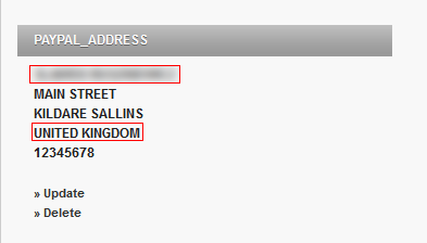

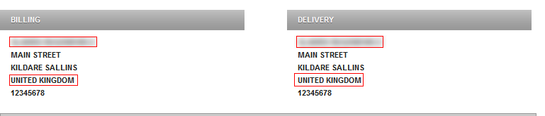

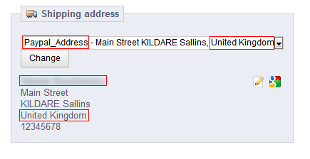

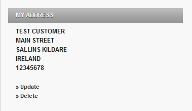

Slava Posted February 17, 2014 Share Posted February 17, 2014 HI, I'm using: PrestaShop 1.5.6.2 Paypal 3.6.5 (Sandbox mode) I created an account with the following: MY ADDRESS Test Customer Main Street Sallins Kildare Ireland 12345678 Then I made order choosing above address. After order I noticed that the address is changed in:My Account -> Order historyMy Account -> My AddressesBefore I made order the title of the address was MY ADDRESS after ordering PAYPAL_ADDRESSAlso client's name and the name of the country was changed. also in BO -> Orders -> order which I made -> Delivery address I can see not correct address It seems that Paypal returns and overrides the data. Could someone explain what is going on please. Link to comment Share on other sites More sharing options...
