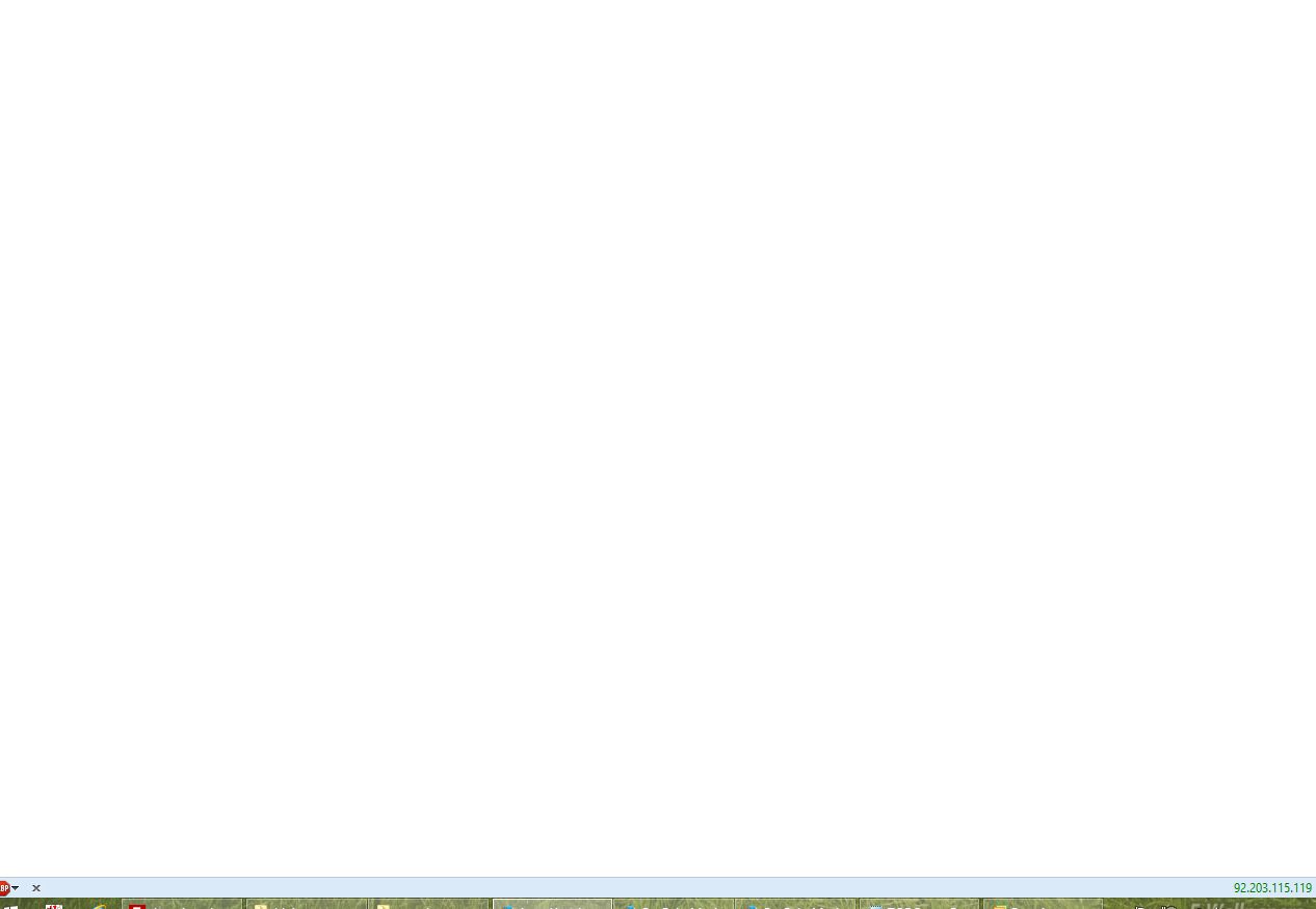

tobyffm Posted February 15, 2014 Share Posted February 15, 2014 (edited) Hi, i have latest PayPalModule installed on latest PrestaShop (1.5.6). Customer can go through order process, but when choosing PayPal as Payment Method, the customer only gets a completely white page, nothing else. I already read on the forums solutions like that: http://www.prestashop.com/forums/topic/222188-solved-pay-with-paypal-blank-screen/ They tell to change if ($cart_currency !== $currency_module) iin process.php, but in my process.php it's already like this as default, so no help for me. Can somebody help me with this? Cheers! EDIT: I found out that it works when I enter my shop by the extended webadress / subdomain, if I enter it via my .de domain with redirection to the extended address, it does not work, why that?! Edited February 15, 2014 by tobyffm (see edit history) Link to comment Share on other sites More sharing options...

tobyffm Posted February 16, 2014 Author Share Posted February 16, 2014 (edited) <meta http-equiv="ROBOTS" content="NOINDEX,FOLLOW"></head><frameset rows="100%,*" border="0"><frame name="_redirected_content_" src="http://edited" scrolling="auto" frameborder="0"><noframes><body lang=en>Your browser does not support framesets.<a href="http://edited">Please click hereto be redirected to the final page.</a></body></noframes> this is all what it does say I already wanted to try with Internet Explorer for example, but then I get another problem:The cart does not work in IE at all. (different problem) Edited February 16, 2014 by tobyffm (see edit history) Link to comment Share on other sites More sharing options...
