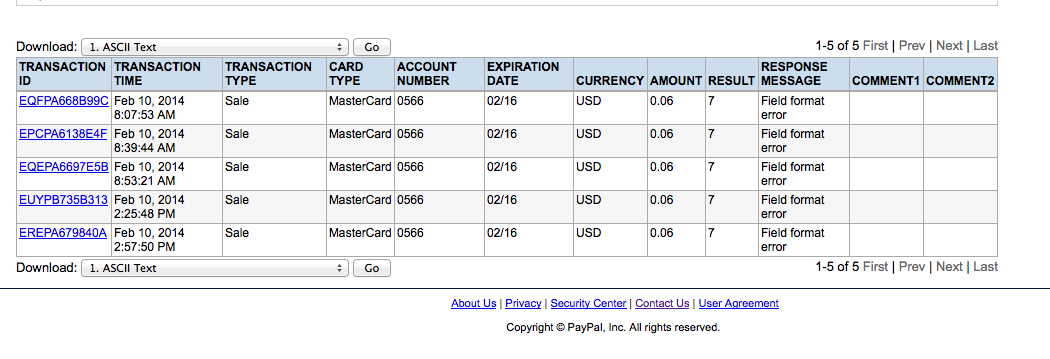

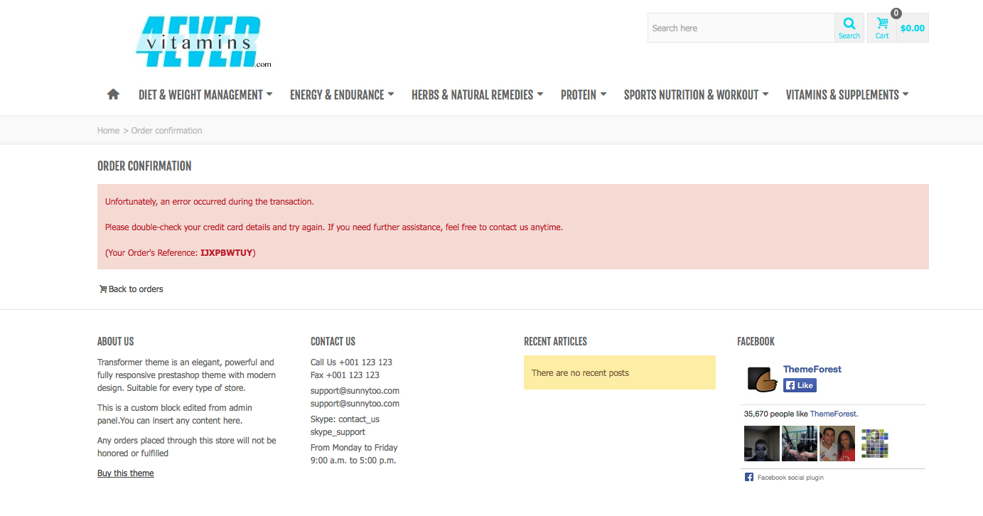

tino73 Posted February 11, 2014 Share Posted February 11, 2014 I Have a PayPal Payment Advanced account and I use PayPal USA, Canada module. Unfortunately at the order confirmation stage I only receive an error message every time someone tries to purchase something in my website and the transaction doesn't go through. I contacted PayPal and they told me that the module is failing to pass the name and address to PayPal. Anyone has any idea how to check this? I attached images of the error in my shopping cart and also the report on my Paypal Payment Advanced Manager. Thank you all for the help. Link to comment Share on other sites More sharing options...

Naldinho Posted February 24, 2014 Share Posted February 24, 2014 I suspect I am currently having the same issue. Log into PayPal manager and select reports followed by daily activity setting the date for when you last tested. Pick any of the transaction IDs and you'll likely find that the Billing Info is missing. If you click for more details at the bottom you'll likely find Response Code 10561 as the error message. What this means is that PrestaShop is not sending the billing info to PayPal which apparently PayPal requires for validation of the credit card. I've been looking for a solution and so far have found two other people having the same issue but no solution. If you fixed this please post a solution here. I will look for a little bit longer but if I can't find an answer I'm just going to buy one of the commercial modules. Link to comment Share on other sites More sharing options...
