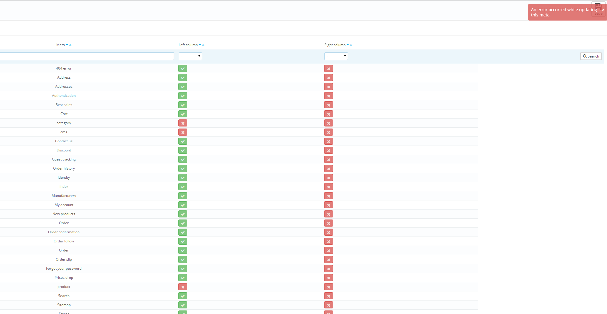

I have the same problem. I use non responsive theme based on prestashop 1.5 default with several modification. After successfully upgrade to 1.6.0.5 before minutes i can`t hook left column on category page, product page and cms page. Have the same same error message like fire2:
"An error occurred while updating this meta"
I try to disable/enable other meta and don`t have problem with other. But this ( category page, product page and cms page ) is disabled by default and need to find issue to problem.
Attach picture from BO. Live (test) store: markov.detelinmarkov.com

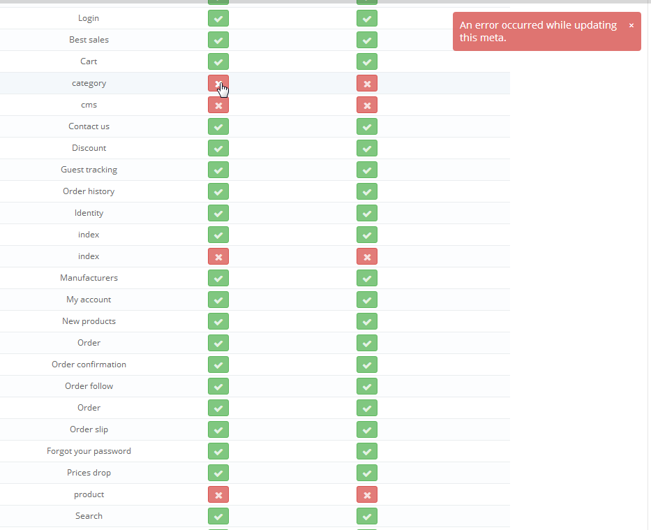

After installing 1.6
i cant activate the left and right column on product page.
got the same error "An error occurred while updating this meta"

I install clean 1.6.0.2 prestashop. Import my modified 1.5 theme and then i upgrade to 1.6.0.5
After upgrade i have 2 time problem meta! See picture:

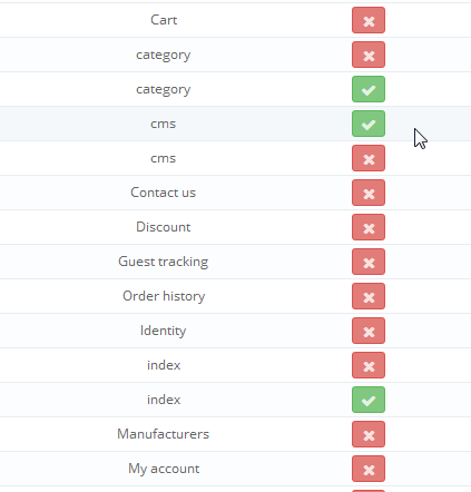

Fresh install here with default 'bootstrap' theme, with some minor modifications in CSS, also not displaying left_column on category, CMS, frontpage, product.
It does however display in search_results page, strangely.

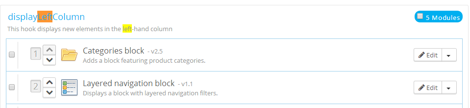

I didnt work for me right out of the box, but I fixed it eventually.
Go to "Positions" and find "LeftColumn", then edit each block manually. It worked for me, I attached both images. B)

hello
check modules attached to left column (and to right also)
i bet on exceptions
go to modules > positions
search for your columns hooks, and click on edit button near each module attached to these lists.
verify "exceptions" field for each of them.
  • Like 1
Vekia,
I try your fix yesterday but not work for me.
I can`t turn on left column in guest-tracking page. Try to add "guest-tracking" in Emilien SQL code but again do not show left column.
 SET NAMES 'utf8';
  ALTER TABLE `ps_order_invoice_tax` ADD INDEX (`id_tax`);
INSERT IGNORE INTO `ps_meta` (`id_meta`, `page`, `configurable`) VALUES
  (NULL, 'products-comparison', '1'),
  (NULL, 'cms', '0'),
  (NULL, 'category', '0'),
  (NULL, 'product', '0'),
  (NULL, 'guest-tracking', '0'),
  (NULL, 'module-bankwire-payment', '0'),
  (NULL, 'module-bankwire-validation', '0'),
  (NULL, 'module-cheque-validation', '0'),
  (NULL, 'module-cheque-payment', '0');
INSERT IGNORE INTO `PREFIX_theme_meta` ( `id_theme` , `id_meta` , `left_column` , `right_column` )
  SELECT `ps_theme`.`id_theme` , `ps_meta`.`id_meta` , `default_left_column` , `default_right_column`
  FROM `ps_theme` , `ps_meta`;
Ideas how to fix it?

Well I too have been having no success with all the fixes listed. For me what finally worked was:
Modules > Postions - displayLeftColumn
Edit New Products block and using CTRL unselect 'index' which was highlighted, then Save
This then added that block to my left column on home page
What seems to be happening is that despite all other changes proposed, in some cases, all the modules assigned by default to displayLeftColumn have an override set so they don't display. I'm not sure if this is something left over from above fixes or not, but by manually updating those exceptions lists for each module I wanted in left column I was able to ger them to display.

Hello everyone, I had tried all of the previous solutions to no avail. I then downloaded a fresh copy of prestashop 1.6 and extracted the default-bootstrap template and installed it, and like magic, we had a left column. This was the only solution that worked for me. Hope this helps some of you guys.
I did that already with no change. I copied the bootstrap theme folder from a fresh install and copied over the existing theme. Once earlier too I had to do a fresh reinstall for a new version case the upgrade had severe faults, and it was very difficult cause I could not import the orders database.
I just solved my problem, paste the same following code in the database via phpmyadmin in the SQL box and click Go. The category,cms and index values for left column were being considered as 0 even when set to 1 in the database tables. The code ignores the 0 .
The left column appeared on category pages ie when I select a category in the menu.
(NULL, 'cms', '0'),
INSERT IGNORE INTO `ps_theme_meta` ( `id_theme` , `id_meta` , `left_column` , `right_column` )

Mine problem is, that I can see Left Column on Home, on Product, but not on Product List. Any idea to resolve this problem? Thanks.
go to localization > positions
search for displayLeftColumn list of modules
then click on edit button near each of the module attached to list
check "exceptions" field, if there is any exception defined: just remove it.
  • Like 1
