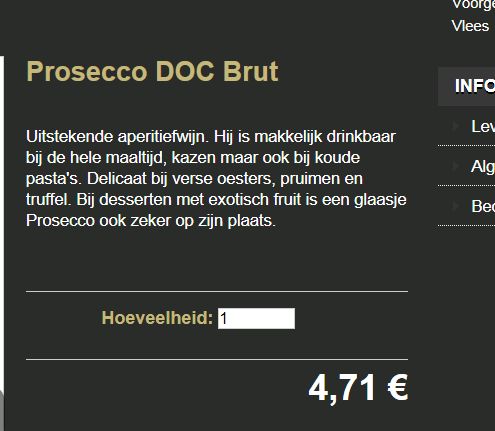

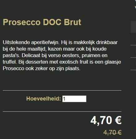

pat123 Posted February 6, 2014 Share Posted February 6, 2014 The prices I enter are BTW-included prices (2 digits) but the system automatically calculates the net-price with also 2 digits (although 3 or 4 are sometimesneeded) So can I change this ? - or disable the auto-calculation of net-prices - or possibility thaqt prices are entered with 3-digits (and if needed used for further calculation F.e. when I enter a taks-included price (21%) of 4.70 , the net-price is 3.884297521 (for ease 3.885 ) The system reduces this to 3.88 and displays the price as attach. (a "fake"-pricerule ) However if I enter 4.71 ( which is net : 3.89256 or 3.89) the "fake"-rule is not there. Or does the system has a problem with rounding of ? (3.8849 : fourth digit is 9 so 3.885 and then ??? to go to a 2-digit number) Link to comment Share on other sites More sharing options...

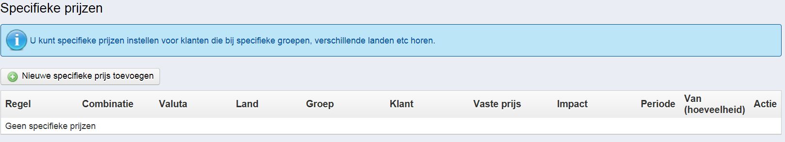

pat123 Posted February 7, 2014 Author Share Posted February 7, 2014 OK, I made a mistake (I am not a math-specialist, you apparently are) But how do you explain the "fake"-pricerules I have. As you can see in file 4.70.jpg the 4.70 price is striked through as if a price-)rule (involving 0% discount) is valid. this is not the case when the price is 4.71 (4.71.jpg) And for the record there is no special price for this product (see prijsregel.jpg) Link to comment Share on other sites More sharing options...
stottycabanas Posted February 7, 2014 Share Posted February 7, 2014 Pat, I can't explain that off the top of my head, but I notice you had this strikethrough problem before in a thread you've marked as solved: http://www.prestashop.com/forums/topic/306375-solved-price-strike-through-although-not-in-promotion/ Is it possible to apply the same solution as before? Cheers, Dave Link to comment Share on other sites More sharing options...
