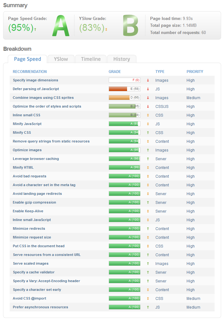

tztudio Posted February 4, 2014 Author Share Posted February 4, 2014 Here are the results of GTMetrix. I don't know what any of it means. Link to comment Share on other sites More sharing options...
Dh42 Posted February 4, 2014 Share Posted February 4, 2014 Who makes the theme? Also do you have around 80k products in the shop? Link to comment Share on other sites More sharing options...
