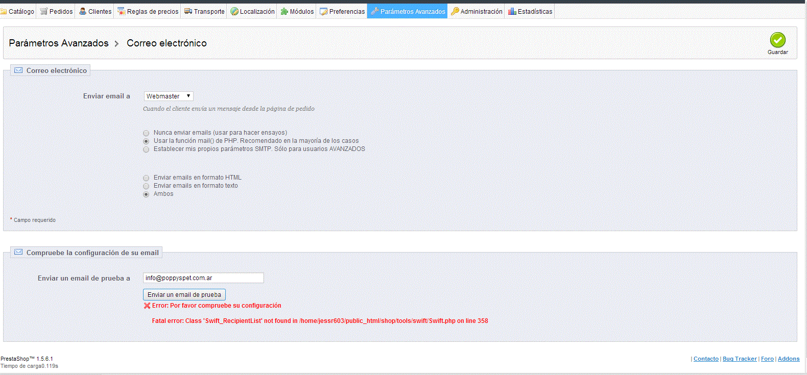

Bolonia Posted January 29, 2014 Share Posted January 29, 2014 Hi teamates , how r u todey?I come to here to find some help , because i have this problem.I m searching abot this error , and i dont have solution. I think the problems is the DB , because i change my domain to other. maybe the fix is there.If u enter to the web www.poppyspet.com.ar and send mail in contact! u se the next error Fatal error: Class 'Swift_RecipientList' not found in /home/jessr603/public_html/shop/classes/Mail.php on line 131 I add a photo when i check send a mail , in BO Advance/email options.Any1 can helpme whit this ?Thanks a lot. Jon @ sry my english is no very good , i hope u can understandme! Hola amigos , como estan?bueno vengo nuevamente al foro ya que no puedo dar con este problema , estuve investigando y aparentemente es un problema de DB pero la verdad no encuentro donde puede estar la falla.Migre la tienda de servidor y ahora no envia mails. Si envio un mail por contactos me aparece este error : Fatal error: Class 'Swift_RecipientList' not found in /home/jessr603/public_html/shop/classes/Mail.php on line 131 Y en el BO me aparece el error de la imagen! La tienda es www.poppyspet,com,.arDesde ya agradesco toda la ayuda que me puedan brindar! @ Digo yo que parece como un error de BD por que no puede encontrar la linea , nose me parece a mi Link to comment Share on other sites More sharing options...

tuk66 Posted September 12, 2016 Share Posted September 12, 2016 You have one of the latest PrestaShop versions and one or more incompatible (read old) modules that uses/overrides the Mail class. 1 Link to comment Share on other sites More sharing options...
Antakarana Posted September 13, 2016 Share Posted September 13, 2016 You have one of the latest PrestaShop versions and one or more incompatible (read old) modules that uses/overrides the Mail class. I agree... I checked the log errors from server and got the problem... it was override/classes/mail.php file I explained the issue to the creator of my template (warehouse) and he sent me an updated mail.php file which worked 100% Thanks Link to comment Share on other sites More sharing options...
