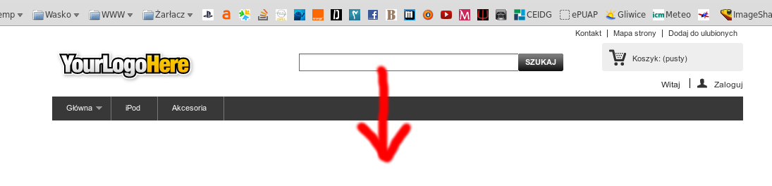

Hi,
I have silly question. How can I move search module from top/header to another place ? When I want add new position for seach module I have error. I read something about hook but I dont know it is solution for me. Is there any simple answer for my question. Sory for my language.

but he said that he want to move it where is how on my first picture here (home hook), so i decided to create another image where i show two possibilities,
if you want to move it to display top (green) - Marty suggestion will work
if you want to move it to Home hook (red) - it will be necessary to modify module php file (to support home hook)

Exactly! In his last message he stated "the green one".
This is the instructions I gave him in the very first response in this thread. No reason to complicate something that is easy to accomplish.

Firstly sorry fo my english :-) Like I said. When I go to "Modules -> Position" and then I click on "Transplant a module" button I have a screen where I choose a search skop module and hook into a "displayTop (Top of pages)" or "display Header" I have the same error "This module cannot be transplanted to this hook." What is wrong ?
you don't have to transplant this module.
go to modules > positions and search for "displayTop" modules list
then move block search module below the top menu module on this list. just drag'n'drop it or click on arrow to change its position

modules> positions, search for displayTop modules list and move search block module below the top horizontal menu
exactly as it is described one page before (in this topic)

you have to move it inside displayTop modules list, not transplant it somewhere else.
move it below the top hotizontal menu module on displayTop modules list.
OK, third time I understood... I did it.
Anyway I tried to drag the block out from displayTop container... :) Sorry, and thank you for patience!
