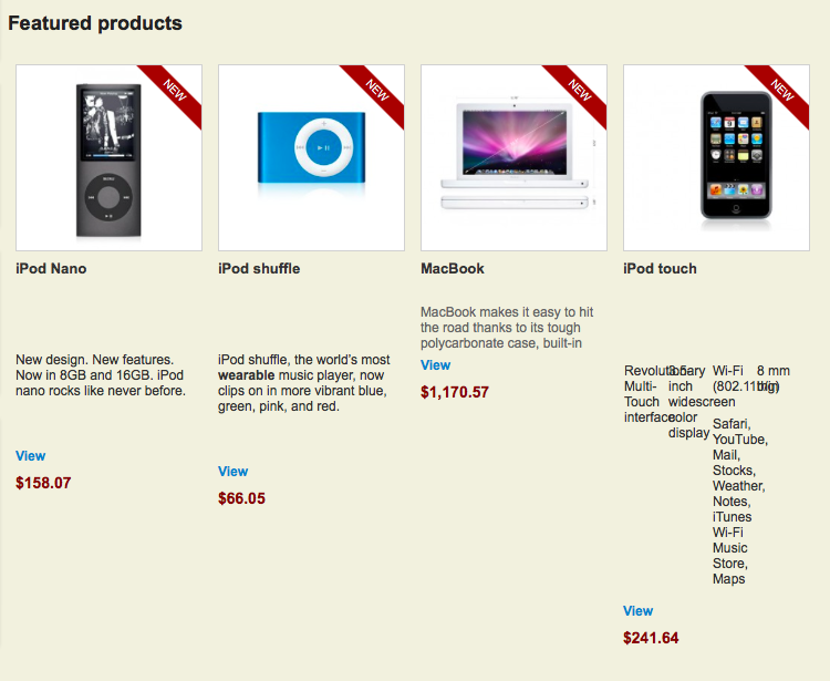

CJH Posted January 27, 2014 Author Share Posted January 27, 2014 I've looked in a few .tpl files. Taking the one you have as an example, homefeatured.tpl, I have this code: <p class="product_desc"><a href="{$product.link|escape:'htmlall':'UTF-8'}" title="{$product.description_short|strip_tags:'UTF-8'|truncate:360:'...'}" >{$product.description_short|strip_tags:'UTF-8'|truncate:360:'...'}</a></p> Which isn't quite the same as yours. This is the only place that strip_tags shows up (there are two of them here). If I remove |strip_tags:'UTF-8' in both, the page does change. The gap between the heading and the short description text increases, but the formatting does not change. In blockviewed.tpl, the code is here (only one instance of strip_tags): description_short|strip_tags:'UTF-8'|truncate:44}</a></p> Removing |strip_tags:'UTF-8' causes the text to become bolder and bigger, and spread outside the box for lack of space, but no italics return Is what I tried correct? Link to comment Share on other sites More sharing options...

vekia Posted January 28, 2014 Share Posted January 28, 2014 just use {$product.description_short} without truncate function. can you show contents of your homefeatured.tpl file ? also, what file you exactly changed? can you show path ? Link to comment Share on other sites More sharing options...
CJH Posted January 28, 2014 Author Share Posted January 28, 2014 In homefeatured.tpl the path is: www.wildplaces.co.uk/shop1/themes/axajeio/modules/homefeatured/homefeatured.tpl (I have pasted the contents below): If I change: title="{$product.description_short|strip_tags:'UTF-8'|truncate:360:'...'}" >{$product.description_short|strip_tags:'UTF-8'|truncate:360:'...'}</a></p> to: title="{$product.description_short}" >{$product.description_short}</a></p> There is no change. I've also tried other variations of changing these lines (around line 48), like only taking out the |strip_tags bit and leaving the rest, with no success. Sorry - I do appreciate your time and help in trying to solve this (and I'm very aware of my lack of knowledge. ....................................................... <!-- MODULE Home Featured Products --><div id="featured-products_block_center" class="block clearfix"> <h2>{l s='Featured products' mod='homefeatured'}</h2> {if isset($products) AND $products} <ul id="product_list" class="products_block grid grid4 clearfix"> {foreach from=$products item=product name=products} <li class="ajax_block_product {if $smarty.foreach.products.first}first_item{elseif $smarty.foreach.products.last}last_item{/if} {if $smarty.foreach.products.index % 2}alternate_item{else}item{/if} clearfix"> <div class="left_block"> {if isset($comparator_max_item) && $comparator_max_item} <p class="compare"> <input type="checkbox" class="comparator" id="comparator_item_{$product.id_product}" value="comparator_item_{$product.id_product}" {if isset($compareProducts) && in_array($product.id_product, $compareProducts)}checked="checked"{/if} autocomplete="off"/> <label for="comparator_item_{$product.id_product}">{l s='Select to compare' mod='homefeatured'}</label> </p> {/if} </div> <div class="center_block"> <a href="{$product.link|escape:'htmlall':'UTF-8'}" class="product_image" title="{$product.name|escape:'htmlall':'UTF-8'}"> <img src="{$link->getImageLink($product.link_rewrite, $product.id_image, 'home_default')|escape:'html'}" alt="{$product.legend|escape:'htmlall':'UTF-8'}" /> {if isset($product.new) && $product.new == 1}<span class="new">{l s='New' mod='homefeatured'}</span>{/if} </a> <h3><a href="{$product.link|escape:'htmlall':'UTF-8'}" title="{$product.name|escape:'htmlall':'UTF-8'}">{$product.name|escape:'htmlall':'UTF-8'|truncate:35:'...'}</a></h3> <p class="product_desc"><a href="{$product.link|escape:'htmlall':'UTF-8'}" title="{$product.description_short|strip_tags:'UTF-8'|truncate:360:'...'}" >{$product.description_short|strip_tags:'UTF-8'|truncate:360:'...'}</a></p> </div> <div class="right_block"> {if ($product.id_product_attribute == 0 || (isset($add_prod_display) && ($add_prod_display == 1))) && $product.available_for_order && !isset($restricted_country_mode) && $product.minimal_quantity <= 1 && $product.customizable != 2 && !$PS_CATALOG_MODE} {if ($product.allow_oosp || $product.quantity > 0)} {if isset($static_token)} <a class="button ajax_add_to_cart_button exclusive" rel="ajax_id_product_{$product.id_product|intval}" href="{$link->getPageLink('cart',false, NULL, "add=1&id_product={$product.id_product|intval}&token={$static_token}", false)|escape:'html'}" title="{l s='Add to cart' mod='homefeatured'}">{l s='Add to cart' mod='homefeatured'}</a> {else} <a class="button ajax_add_to_cart_button exclusive" rel="ajax_id_product_{$product.id_product|intval}" href="{$link->getPageLink('cart',false, NULL, "add=1&id_product={$product.id_product|intval}", false)|escape:'html'}" title="{l s='Add to cart' mod='homefeatured'}">{l s='Add to cart' mod='homefeatured'}</a> {/if} {else} <span class="exclusive">{l s='Add to cart' mod='homefeatured'}</span> {/if} {/if} <a class="lnk_more" href="{$product.link|escape:'htmlall':'UTF-8'}" title="{l s='View' mod='homefeatured'}">{l s='View' mod='homefeatured'}</a> <p class="price_container"> {if (!$PS_CATALOG_MODE AND ((isset($product.show_price) && $product.show_price) || (isset($product.available_for_order) && $product.available_for_order)))} <div class="content_price"> {if isset($product.show_price) && $product.show_price && !isset($restricted_country_mode)}<span class="price" style="display: inline;">{if !$priceDisplay}{convertPrice price=$product.price}{else}{convertPrice price=$product.price_tax_exc}{/if}</span><br />{/if} </div> {if isset($product.online_only) && $product.online_only}<span class="online_only">{l s='Online only' mod='homefeatured'}</span>{/if} {/if} </p> </div> </li> {/foreach} </ul> {else} <p>{l s='No featured products' mod='homefeatured'}</p> {/if}</div><!-- /MODULE Home Featured Products --> Link to comment Share on other sites More sharing options...

CJH Posted January 29, 2014 Author Share Posted January 29, 2014 Okay, I tried the code change. It increased the gap between the heading and short description text, but did not change anything else (so I put the file back as it was). This feels so odd, because the product titles in the NEW block are in bold as they should be, but not in the VIEWED block (for example). But there again, the layout is different in these blocks (in the default and this new theme in use, both): NEW has the image above the bold title and text, but Viewed has the image on the left and the title (in bold in default, not in this theme) and text on the right. The code obviously differs for the layout - perhaps a clue, or not; I am not a coder, but just look for clues. I think, though it looks odd to me, that the lack of italics in descriptions in block boxes must be a Prestashop thing. But it would still be good to find what is preventing the bold in titles inside block boxes, and why no italics show up in short descriptions in Product pages. The bold headings are set by Prestashop, it appears, but as mentioned before the italics are inserted by me when adding the product. The code is present, because I can either copy/paste it into an html file and it displays, or else just switch to default theme and it displays. It does not show visibly in tinymce editor, even though the code is in there (and can be inspected). Andrej - I really appreciate your help. I think Theme Maker as a concept and working method is awesome and despite searching for hours for a theme to purchase that would do what I want, Theme Maker has been my best (and only) route to where I want to be. Thanks for your time and input. Link to comment Share on other sites More sharing options...
