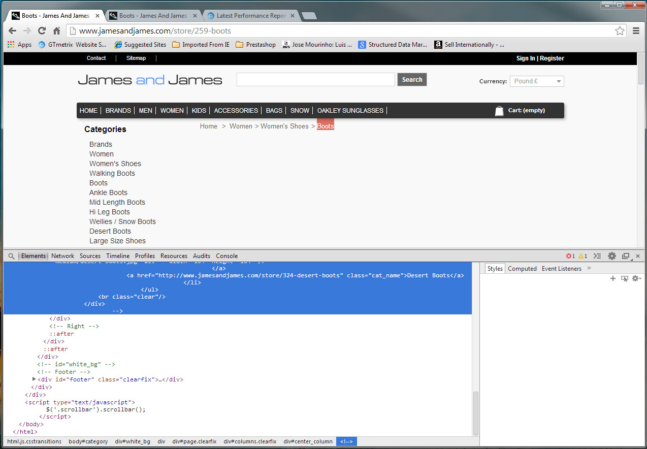

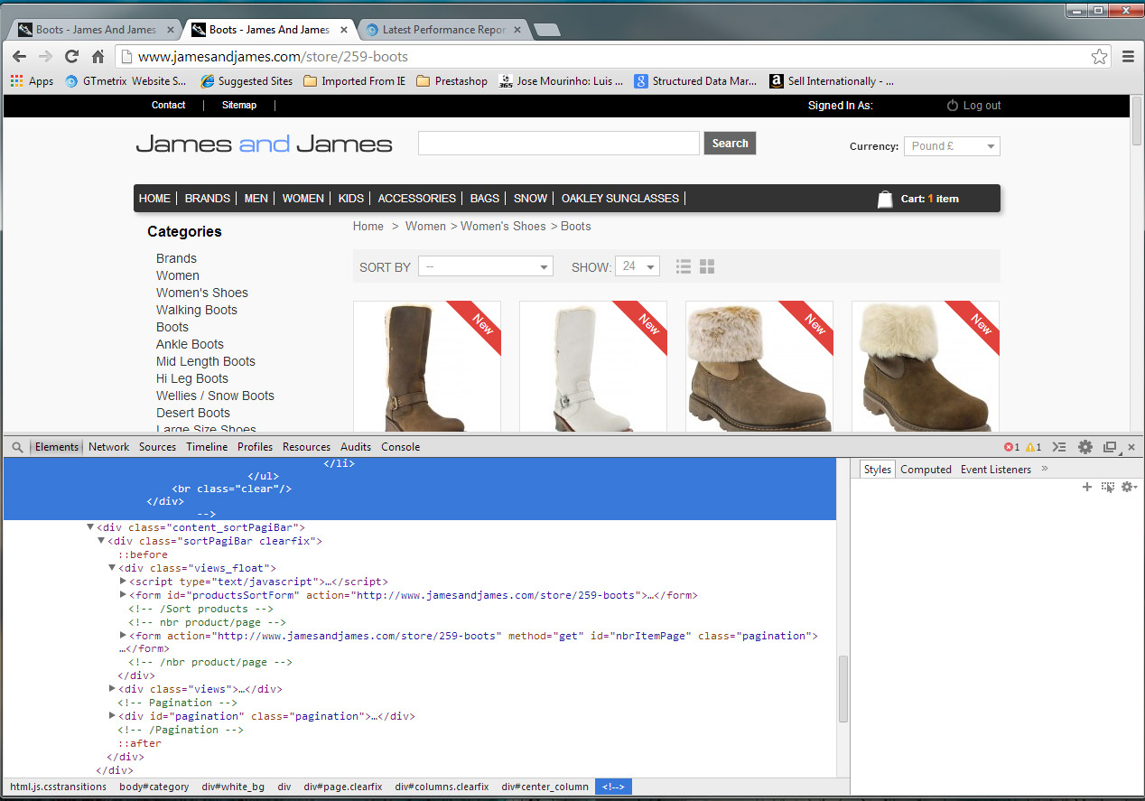

garyjj127 Posted January 23, 2014 Author Share Posted January 23, 2014 Any help at all?? I have added a couple of screenshots below: Link to comment Share on other sites More sharing options...
