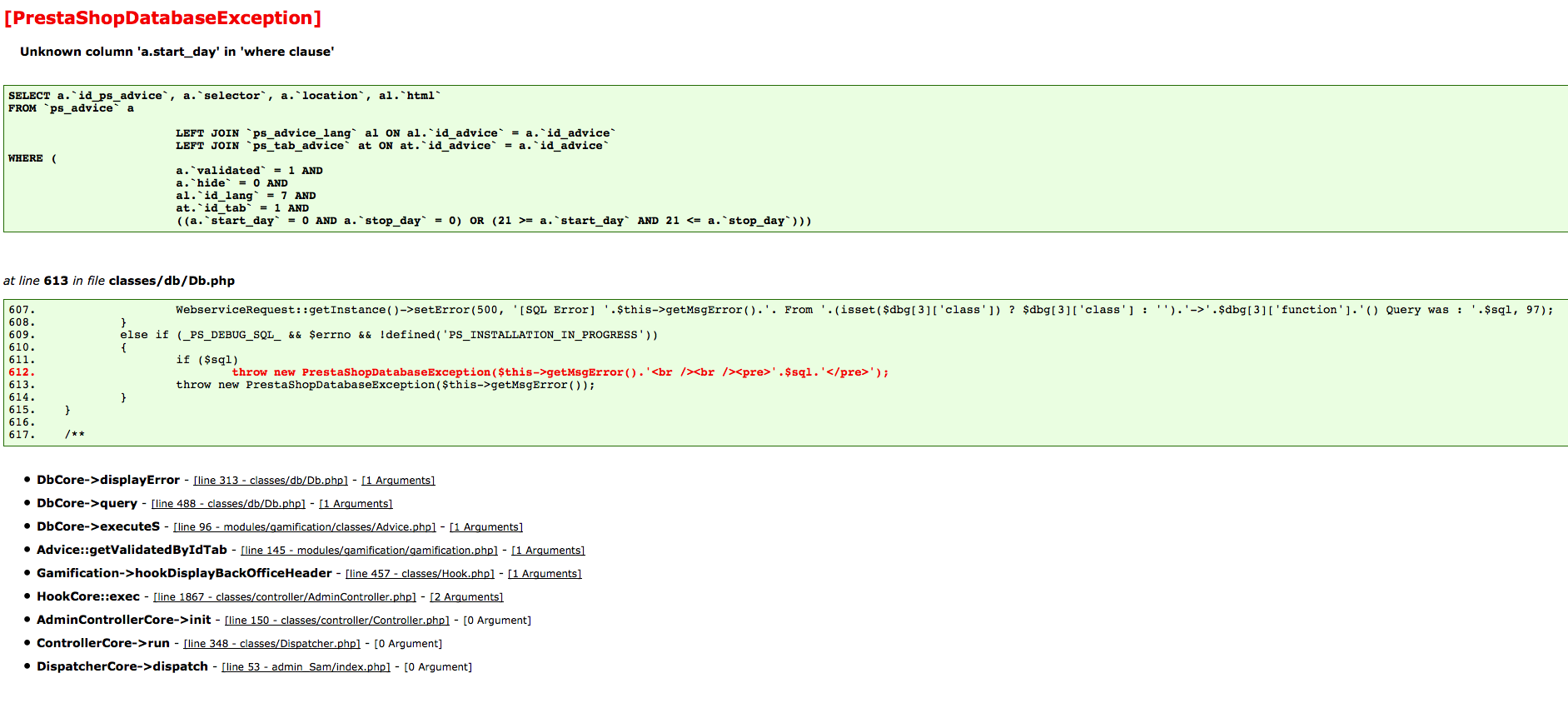

Optimus_Sam Posted January 20, 2014 Share Posted January 20, 2014 (edited) Hi guys, I can't seem to get in to my BO all of the sudden... I made a screenshot so you can see =) Anyone had this problem before? Cos i'm stuck Grtz, Sam Edited January 21, 2014 by Optimus_Sam (see edit history) Link to comment Share on other sites More sharing options...
vekia Posted January 20, 2014 Share Posted January 20, 2014 go to ps_advice table and... just create this column. 1 Link to comment Share on other sites More sharing options...

vekia Posted January 21, 2014 Share Posted January 21, 2014 if you've got an access to prestashop database manager like phpmyadmin, check this: 2 Link to comment Share on other sites More sharing options...

Optimus_Sam Posted January 21, 2014 Author Share Posted January 21, 2014 Hi Vekia, I did exactly as the awesome video instructed. However i get this now: Unknown column 'a.start_day' in 'where clause' Link to comment Share on other sites More sharing options...
vekia Posted January 21, 2014 Share Posted January 21, 2014 lol, please follow guide one more time but instead "hide" use "start_day" as new column name 1 Link to comment Share on other sites More sharing options...

vekia Posted January 21, 2014 Share Posted January 21, 2014 well, just wondering what module applied these changes, you updated some of the modules ? i just want to find this crappy addon i can't reproduce this issue Link to comment Share on other sites More sharing options...
Optimus_Sam Posted January 22, 2014 Author Share Posted January 22, 2014 I don't know what caused this . But i did do a server reboot... maybe that was the cause? Link to comment Share on other sites More sharing options...
vekia Posted January 22, 2014 Share Posted January 22, 2014 problem solved it was gamification module update Link to comment Share on other sites More sharing options...
