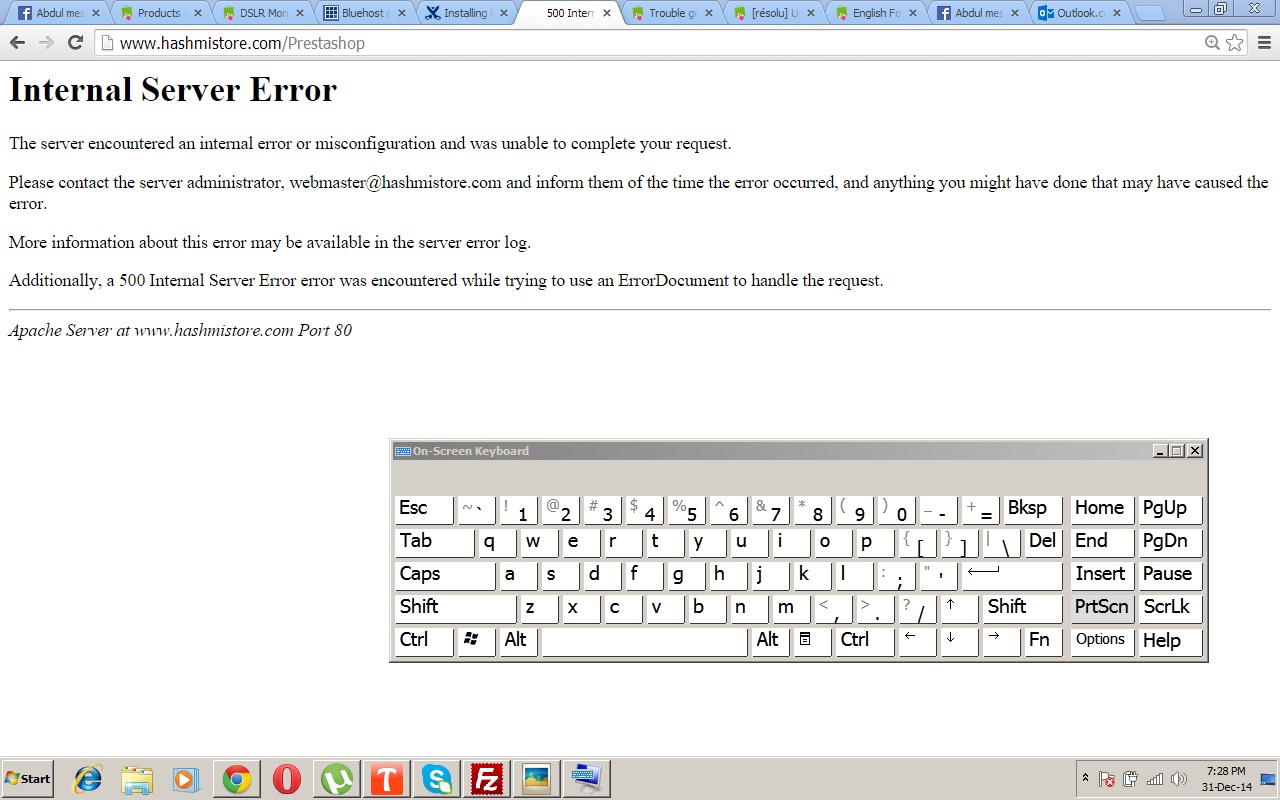

hashmi photos Posted December 31, 2014 Share Posted December 31, 2014 please help me i have this error when i launch installer. Link to comment Share on other sites More sharing options...
