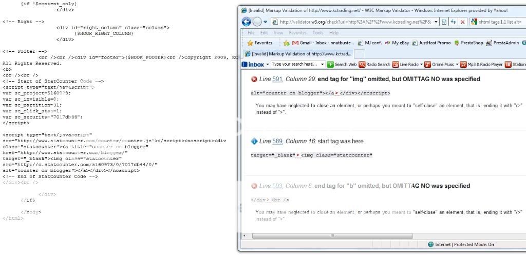

nutbuster Posted October 5, 2009 Share Posted October 5, 2009 A lot of the errors I am getting from W3C are from add on...like a page counter.Is the problem that it is not compatatable with Xhtml?Here are the W3C errors on just the counter:Here is the Link:http://validator.w3.org/check?uri=http://www.kctrading.net/&charset;=(detect+automatically)&doctype=Inline&ss=1&group=0&No200=1&verbose=1&user;-agent=W3C_Validator/1.654 Line 593, Column 30: XML Parsing Error: Opening and ending tag mismatch: img line 591 and a alt="counter on blogger" > Line 593, Column 36: XML Parsing Error: Opening and ending tag mismatch: a line 589 and div alt="counter on blogger" > Line 593, Column 47: XML Parsing Error: Opening and ending tag mismatch: div line 588 and noscript alt="counter on blogger" >587.[removed][removed]589.class="statcounter">594.<!-- End of StatCounter Code -->595. 596.597. 598.599.</body>600.</html>There has got to be an easy to decifer all of this code? Link to comment Share on other sites More sharing options...
nutbuster Posted October 5, 2009 Author Share Posted October 5, 2009 Ok to make it a bit simpler here is a pic side by side:http://i618.photobucket.com/albums/tt266/doug_k48/counter1.jpgI have three errors on the couner but for the life of me I can see what they want me to do!Thanks, Link to comment Share on other sites More sharing options...
nutbuster Posted October 6, 2009 Author Share Posted October 6, 2009 Rocky figured it out here on post #8http://www.prestashop.com/forums/viewthread/30008/general_discussion/wysiwyg_bug__prestashop_1_dot_2_dot_3_dot_0__will_not_display_____a_m_p___for___under_w3c Link to comment Share on other sites More sharing options...
