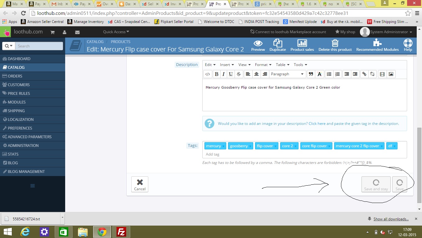

rohitsh511 Posted March 12, 2015 Share Posted March 12, 2015 (edited) Same issue Please find screen shot als The price panel is showing nothing in product catalog This is happening after i updated my prestashop from 1.6.0.9 to 1.6.0.14 Edited March 12, 2015 by rohitsh511 (see edit history) Link to comment Share on other sites More sharing options...
NemoPS Posted March 13, 2015 Share Posted March 13, 2015 Known issue: https://www.prestashop.com/forums/topic/393218-16011-problem-with-saving-products/page-8?do=findComment&comment=2001569 Link to comment Share on other sites More sharing options...

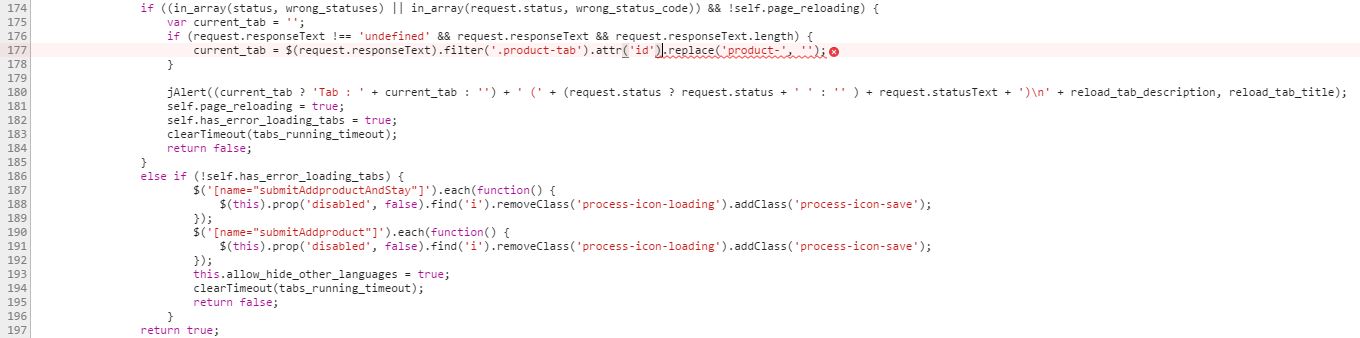

vucumbra Posted October 25, 2016 Share Posted October 25, 2016 Remove the following lines from the file /adminXXXX/themes/default/template/controllers/products/helpers/form/form.tpl: https://github.com/P...m.tpl#L252-L254 perfect! Thx 1 Link to comment Share on other sites More sharing options...
ctcamp Posted October 26, 2016 Share Posted October 26, 2016 Remove the following lines from the file /adminXXXX/themes/default/template/controllers/products/helpers/form/form.tpl: https://github.com/P...m.tpl#L252-L254 Hi there Thank you, this also worked for me. i would just like to find out, my new site - www.dealstoday.co.za - now stops spinning, but it takes a couple of minutes, is there anything else i can change to speed it up somewhat. Thank you again Blessings Link to comment Share on other sites More sharing options...
thanos26 Posted October 26, 2016 Share Posted October 26, 2016 Remove the following lines from the file /adminXXXX/themes/default/template/controllers/products/helpers/form/form.tpl: https://github.com/P...m.tpl#L252-L254 Thank you very much mdekker!!! I can go to sleep now! Solved on Prestashop 1.6.5. 1 Link to comment Share on other sites More sharing options...
Fred Fournier Posted October 27, 2016 Share Posted October 27, 2016 Remove the following lines from the file /adminXXXX/themes/default/template/controllers/products/helpers/form/form.tpl: https://github.com/P...m.tpl#L252-L254 Seems to work on PS 1.6.0.9, hope it holds! Thank you very much! Had this kind of bug suddendly: instead of saving edits inside products, I was thrown out of it, at the catalogue page... Just to know, what this change does? Link to comment Share on other sites More sharing options...
NemoPS Posted October 28, 2016 Share Posted October 28, 2016 Nice shot Dekker, thanks Link to comment Share on other sites More sharing options...
Innar.Hunt Posted November 1, 2016 Share Posted November 1, 2016 Solution by mdekker worked also for me on PS 1.6.0.8 Thank you! Link to comment Share on other sites More sharing options...
MReds Posted November 4, 2016 Share Posted November 4, 2016 Remove the following lines from the file /adminXXXX/themes/default/template/controllers/products/helpers/form/form.tpl: https://github.com/P...m.tpl#L252-L254 works for me too!!.. THX!! Link to comment Share on other sites More sharing options...
justbabymart Posted November 5, 2016 Share Posted November 5, 2016 I am experiencing a very annoying situation. Whenever i edit the product, after I press save and stay, it doesn't work and takes me to product catalogue page. In the top, changes saved bar doesn't appear. I am now unable to change prices. Can you please help me out? My website is on cloudflare. Link to comment Share on other sites More sharing options...
cavetech Posted November 5, 2016 Share Posted November 5, 2016 Remove the following lines from the file /adminXXXX/themes/default/template/controllers/products/helpers/form/form.tpl: https://github.com/P...m.tpl#L252-L254 Thank you! It's working!!! Link to comment Share on other sites More sharing options...

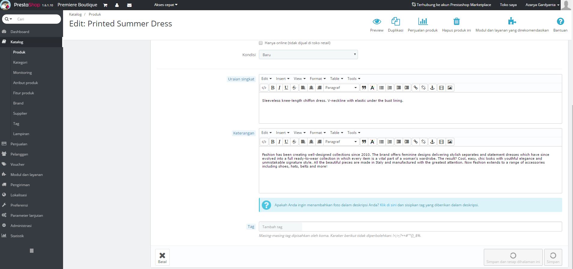

azachan Posted January 9, 2017 Share Posted January 9, 2017 hi, i have the same problem the save button spinning never end i tried Chrome, Firefox, Edge, IE the button only works when i open it from mobile phone please help to solve this problem Prestashop 1.6.1.10 fresh install PHP version 5,6 here is the error console : Link to comment Share on other sites More sharing options...
NemoPS Posted January 9, 2017 Share Posted January 9, 2017 Expand the error so it shows the code at that broken line Link to comment Share on other sites More sharing options...
