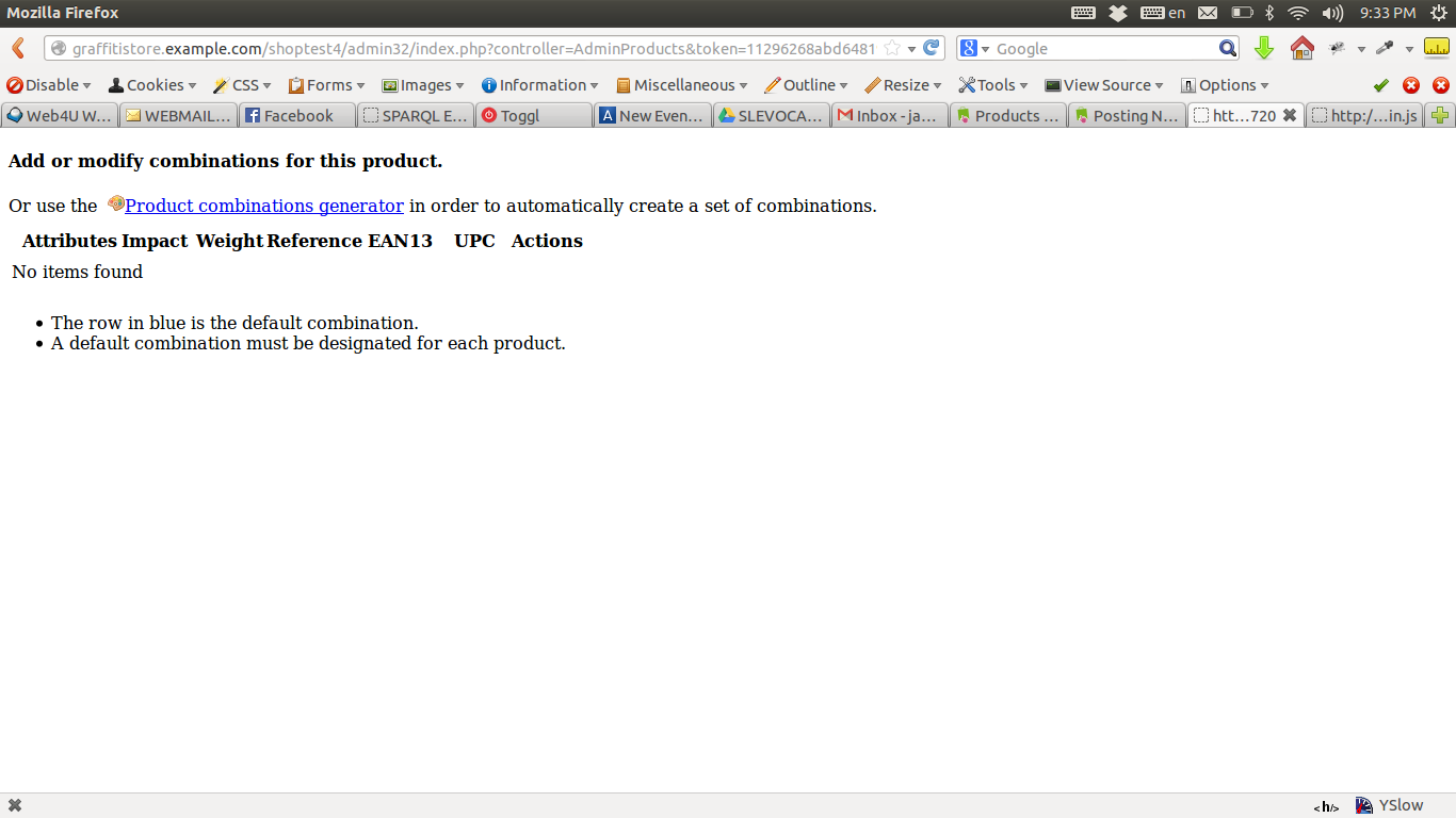

when I go to product details, I can view/edit all tabs except "Combinations" tab - when I click Combinations, I get stuck either with blank grey page or (more often) with the loading animation (spinning arrows forever). It's not possible to click on other section to go back after that, you have to reload the page to display e.g. "Information" tab again. It happens on multiple browsers and multiple computers/operation systems.
What I know about the problem so far:
- it does happen even when adding new product (it does display info that you have to save product first correctly though, after you save product with only it's name filled, you immediately cannot acces the combinations tab)
- page is loaded via ajax correctly - request to "http://mysite.example.com/shoptest4/admin32/index.php?controller=AdminProducts&token=11296268abd6481986d2edc0c3acad1e&id_product=761&action=Combinations&updateproduct&ajax=1&rand=1389126637902" returns 200 OK, and if I put this addres into the browser manually, it seems to work correctly:

Solution:
Turned out the problem was in data in the database - one of the attribute names in table ps_attribute_lang had break at the end. Maybe it might not have been exactly break, not sure why break would cause problems, but phpmyadmin displayed it as a break. Seems prestashop is loading all the attributes in the "attrs" array, and due to this weird ending character, it somehow corrupted the array which resulted in a strange behaviour.
