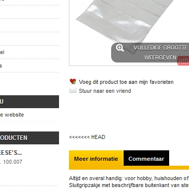

pandorrah Posted January 7, 2014 Share Posted January 7, 2014 Aan de frontend, bij artikelomschrijving gedetailleerd onderaan, verschijnt: <<<<<<< HEAD Iemand enig idee? En hoe dit aan te passen? Link to comment Share on other sites More sharing options...
vekia Posted January 7, 2014 Share Posted January 7, 2014 solution here; http://www.prestashop.com/forums/topic/299505-solved-a-strange-bug-on-the-product-view-showing-some-sort-of-code/?hl=%2Bupdated&do=findComment&comment=1515138 1 Link to comment Share on other sites More sharing options...
pandorrah Posted January 8, 2014 Author Share Posted January 8, 2014 Thank you vekia, it solved the problem Link to comment Share on other sites More sharing options...

Vivian Tan Posted February 26, 2014 Share Posted February 26, 2014 solution here; http://www.prestashop.com/forums/topic/299505-solved-a-strange-bug-on-the-product-view-showing-some-sort-of-code/?hl=%2Bupdated&do=findComment&comment=1515138 I did as said in the topic, but the problem still remains, I can't reply there since it was locked Link to comment Share on other sites More sharing options...
vekia Posted February 26, 2014 Share Posted February 26, 2014 hello can you describe your problem? it is exactly the same? 1 Link to comment Share on other sites More sharing options...
Vivian Tan Posted February 27, 2014 Share Posted February 27, 2014 hello can you describe your problem? it is exactly the same? yes it's exactly the same, I've done what it's said on the topic but problem still persists. Or maybe there's a lag and it takes some time for the module to update it's tpl file, idk Link to comment Share on other sites More sharing options...
vekia Posted February 27, 2014 Share Posted February 27, 2014 have you tried to recompile entire theme and clear smarty cache & autoload cache under adv. paramters > performance tab? 1 Link to comment Share on other sites More sharing options...
Vivian Tan Posted February 27, 2014 Share Posted February 27, 2014 have you tried to recompile entire theme and clear smarty cache & autoload cache under adv. paramters > performance tab? I didn't know that we have to do it, now it's done, thanks so much vekia, and sorry for my ignorance, I'm just getting used to IT, not to say prestashop or anything more complex Link to comment Share on other sites More sharing options...
vekia Posted February 27, 2014 Share Posted February 27, 2014 no worries - i understand so if everything is okay now, you can disable force compile 1 Link to comment Share on other sites More sharing options...
Vivian Tan Posted February 27, 2014 Share Posted February 27, 2014 no worries - i understand so if everything is okay now, you can disable force compile yes, at lease I was able to do so Link to comment Share on other sites More sharing options...
