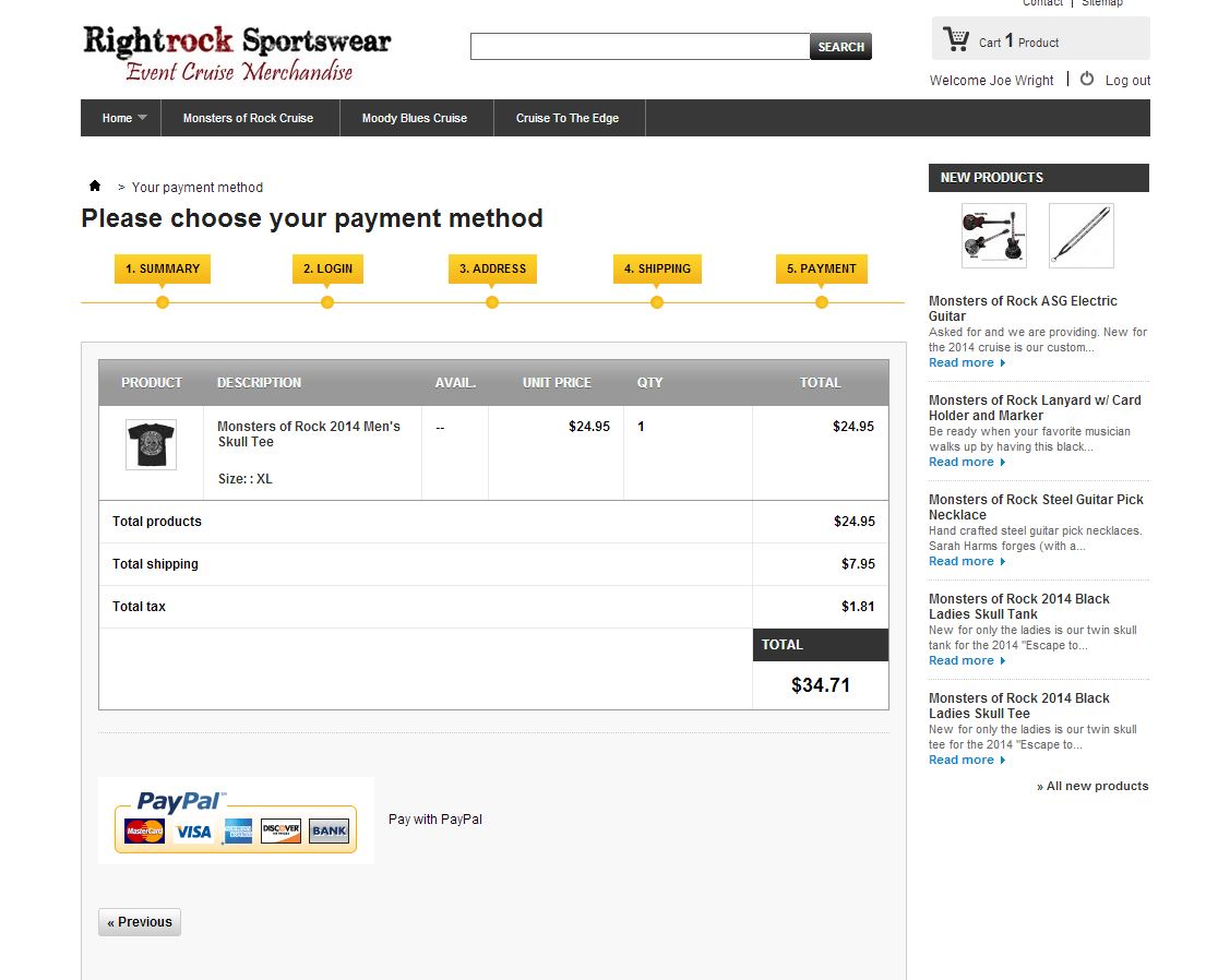

ShirtSeller Posted December 27, 2013 Share Posted December 27, 2013 Hi All, I have a new fresh install of 1.5.6.1 and am getting the following error when checking out with my first test purchase: "We cannot process this transaction because there is a problem with the PayPal email address supplied by the seller. Please contact the seller to resolve the problem. If this payment is for an eBay listing, you can contact the seller via the "Ask Seller a Question" link on the listing page. When you have the correct email address, payment can be made at www.paypal.com." This error comes in on the PayPal side of things I guess: https://www.paypal.com/cgi-bin/webscr?cmd=_flow&SESSION=wU6KokAeYBqeRFzO4NZsyL54jRYUPOGJnVO6tZ7tBCgGRqsq1apnEgAhHDm&dispatch=50a222a57771920b6a3d7b606239e4d529b525e0b7e69bf0224adecfb0124e9b61f737ba21b081986471f9b93cfa01e00b63629be0164db1 My PayPal account is in fine working order. I have reset my PayPal API credentials and I still get the same error. The PyPal module version in my shop is 1.2.7 My site is at http://www.rightrock.com/cruisestore Screenshots are attached Anyone else running into this? 1 Link to comment Share on other sites More sharing options...

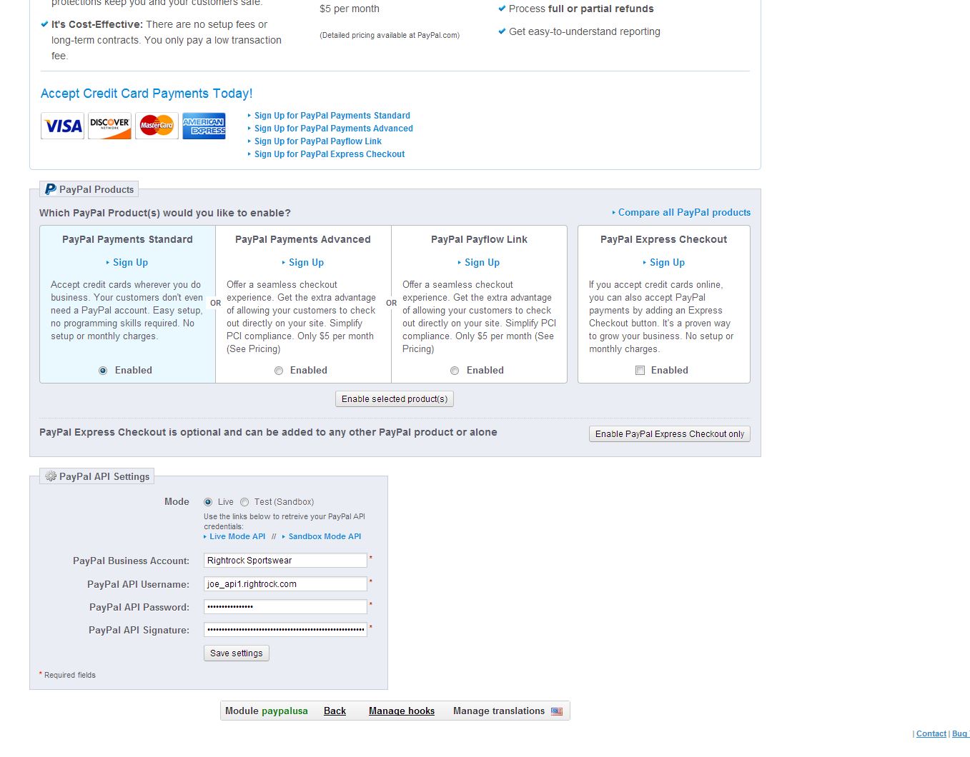

El Patron Posted December 27, 2013 Share Posted December 27, 2013 can you show us the paypal-->module--->configuration screen shot ? Link to comment Share on other sites More sharing options...
ShirtSeller Posted December 27, 2013 Author Share Posted December 27, 2013 On 12/27/2013 at 6:39 PM, El Patron said: can you show us the paypal-->module--->configuration screen shot ? Link to comment Share on other sites More sharing options...
ShirtSeller Posted December 27, 2013 Author Share Posted December 27, 2013 I figured it out. In the PP module config, down in the API settings box where it asks for PayPal Business Account: it needs to be the verified email address in your account, not your business name. Maybe this could be updated to say email so others don't get confused, or maybe it was just me! 3 Link to comment Share on other sites More sharing options...
El Patron Posted December 27, 2013 Share Posted December 27, 2013 On 12/27/2013 at 7:01 PM, ShirtSeller said: I figured it out. In the PP module config, down in the API settings box where it asks for PayPal Business Account: it needs to be the verified email address in your account, not your business name. Maybe this could be updated to say email so others don't get confused, or maybe it was just me! I just tested this (I am running old version in production) but I used email address in PayPal Business Account field and it worked. When I took out the email address it did not work. thanks for telling us how you got on with this! Link to comment Share on other sites More sharing options...
