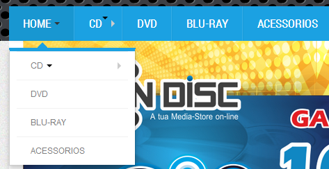

Hi,
Im having some problems with my Top horizontal menu bar,
How I remove this itens from my Home buton? I want the Home buton only to redirect to the main site.
I want to remove the "CD, DVD, ..." from there.
The "CD" tab it not working right
How I fix it?
Can I had something other than the Home for the main parent?

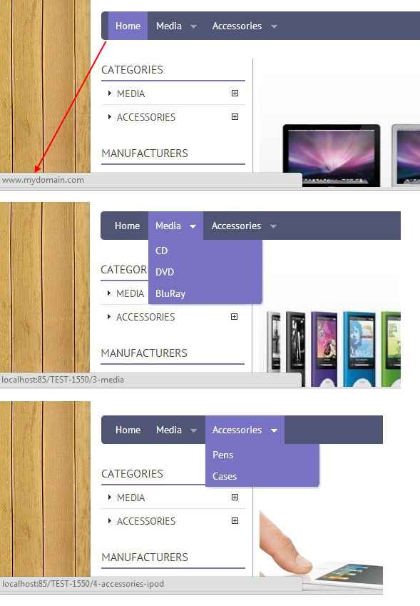

Hi Tyian, welcome to the forums.
Are you trying to achieve something like this?:
If not, can you clarify - perhaps upload some pictures of what you want to achieve.
Cheers, Dave
Hi Stotty,
Yes, that is exactly what I want to achieve.

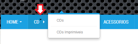

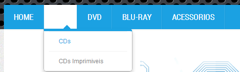

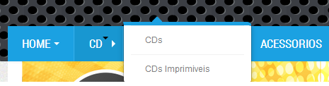

You also know why my "CD" tab is messed up? Like I show it on the pics?
Ex: The little black arrow and when I hover the tab the option cover the others tab in the menu, instead of going under it.
How is rigth now:
How I would like to work:
But your example is exaxtly what I want to achieve. The home like yours and the "Media" tab, etc, like yours.

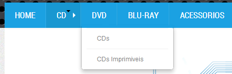

CHange bootstrap.css, at line 4945, and add a top offset. It should be around 40px I guess :)
Thank you, that kind worked.

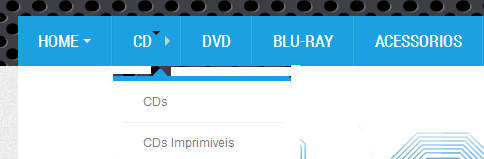

The problem is that the option are under the other tab and not the right tab.
Can I move it a little so she show the option under the right tab.
About the little black arrow? Do you know why is showing like that?
Thank you for the help ;)!
Edited by Tyian (see edit history)
Yes, just change the left offset :)
As for the arrow, it's .caret at about line 4806. Remove the background

EDIT: That breaks the menu I don't know how.
Look all withe.
Thank you very much! :D
You should ask the theme developer, as it's because you are hovering on another list item.

Tyian, are you OK with setting up the category structure?

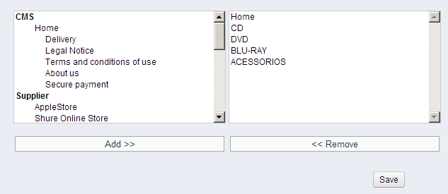

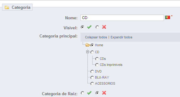

You can set up a new product category called e.g. Media whose parent is the Home category. Then you can amend the existing categories CD, DVD & Bluray so that their parent category is Media. Then add new categories Pens and Cases whose parent category is Accessories.
You can then configure the Top horizontal menu module. I see that you already have the link to the home page as your first entry in the menu. :)  Remove the others, then from the list on the left, select and add the categories Media then Accessories.
Obviously you will need to translate these terms as required.

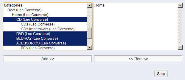

Yes, I think my category structure is ok. The problem is that the sub menu option get mess up and I dont know why.
EX:
My structure:
The Top horizontal module:

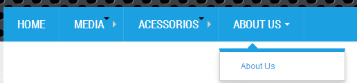

The final result:
What Im going wrong? What is the problem? Why the sub menu get all mess up?

It seems okay to me, you just have to fix css...no? Am I missing something?
If I fix the css it makes it ok, it fix it. I still around the white hover thing.
What is strange is if I create a menu in the CMS tab, it work nicely.
Like you can see, the arrow is correctly and when I hover it not turn white. You can see it online on my site.
I wanted to archive the same result with the Products category.
Maybe it not possible and the problem is from the theme, I don't know.
