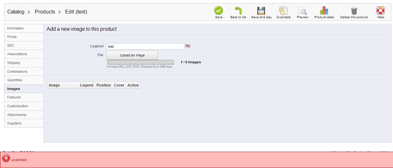

euniceyiewie Posted December 8, 2013 Share Posted December 8, 2013 Dear all, there was an error 'undefined' uploading product image in version 1.5.6.1 and it has nothing to do with the image sizes... Has anyone experience this before ? what am i suppose to do to get it fixed? Kindly advise and Thank you in advance ~ Link to comment Share on other sites More sharing options...
turnkeymaker Posted December 11, 2013 Share Posted December 11, 2013 Edit the js file "fileuploader.js" located in the "js" folder ( js/fileuploader.js ) Then go to line 1075 Replace xhr.setRequestHeader("Content-type","application/x-www-form-urlencoded"); with these two lines of code xhr.setRequestHeader("Content-Type", "application/octet-stream"); xhr.setRequestHeader("processData", false); 5 Link to comment Share on other sites More sharing options...

sttaq Posted November 3, 2014 Share Posted November 3, 2014 I am having the same problem. I uploaded my products using import wizard. A large number of products were uploaded with images but quite a few did not get their images. Since then whenever I try to manually upload an image I get this "undefined" error. On googling I found that some of the images that I intended to upload were too big in dimensions i.e. width x height. So I tried manually uploading smaller images but that still fails with undefined. I have also tried creating a new product and uploading an image and that does not work as well. The last thing I tried is to upload an image to a product which already has an image uploaded but unfortunately this also failed. I am quite sure that this is not a permission issue. Firstly, the script managed to upload a number of images and failed for a few. Secondly, I have checked all the permissions and have now set them to 777 i.e. complete read write access to everyone (not recommended). The only thing that I notice is in the Chrome console I get a 404 error. POST http://mysite/admin/ajax-tab.php?id_product=7&id_category=0&token=bcda…%5D=Product+Name&legend%5B2%5D=Product+Name&qqfile=product.jpg 404 (Not Found) fileuploader.js:1078 qq.extend._upload fileuploader.js:1078 qq.UploadHandlerAbstract.upload fileuploader.js:767 qq.FileUploaderBasic._uploadFile fileuploader.js:401 qq.FileUploaderBasic._uploadFileList fileuploader.js:392 qq.FileUploaderBasic._onInputChange fileuploader.js:375 qq.UploadButton.onChange fileuploader.js:312 (anonymous function) I don't see anything obvious in the cpanel that might not allow me to upload images and as earlier mentioned I have managed to upload a few already so I don't think that is not the case. I hope someone can help out. Link to comment Share on other sites More sharing options...
