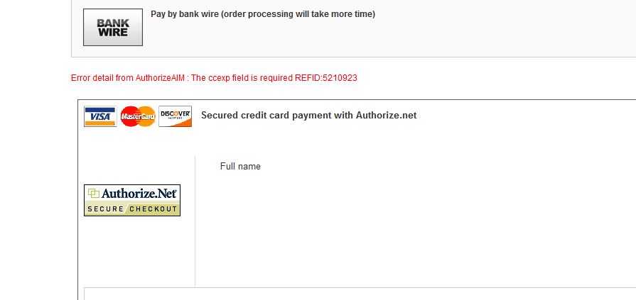

idealecigs Posted December 5, 2013 Share Posted December 5, 2013 *** Errors with validation when configuring NMI and Authorize.net AIM module *** I need help with getting my Prestashop working with the Authorize.net AIM module. I have NMI as my merchant gateway and they use an emulator so I can use the Authorize.net AIM module. Its all installed and URLS were changed to NMI properly but I can't see to get ANY card to go through. NMI Integration specialists couldn't figure it out today and, of course, redirected me back to Prestashop and said the issue was not on their end. I just need someone to work with me or help me out so I can get things up and running. The error i am stuck on now is when I try to process card and click Validate from shopping cart, I receive this error: The ccexp field is required authorize aim ... What could be the issue here? Do you think its an issue with Authorize.net module and my prestashop version? I am using 1.5.6. I will attach my validation.php if you wish to look over it. Any help would be greatly appreciated. Derek Carlson validation.php Link to comment Share on other sites More sharing options...

VapeCrushers Posted December 12, 2013 Share Posted December 12, 2013 This script is badly broken. I spoke with the gateway and this was their response. We see the X_Exp_date as 122. The Exp date used was 12/2015. They have included a fix that was posted by a Prestashop developer. so it's dropping the last 3 digits of they year and putting "2" instead of "15". Any ideas?? Link to comment Share on other sites More sharing options...

VapeCrushers Posted December 12, 2013 Share Posted December 12, 2013 I appreciate all your help! The Validate.php file, is that the only culprit, or are there other files that need to be modified? the code changes should be the same for every site that uses NMI, correct? NMI said to change this: $_POST['x_exp_date_m'].$_POST['x_exp_date_y'] To This: $_POST['x_exp_date'] = str_pad($_POST['x_exp_date_m'],2,'0',STR_PAD_LEFT).$_POST['x_exp_date_y'] However, the left side of the month is not the problem, it is the right side of the Year. The results were: 2013/12/12 19:09:27 (0.157s) < 3|0|122|The ccexp field is required REFID:5214869||P|0|20||27.00| CC|auth_capture||erik|swanson||6041 St Clair Ct |||93063||||||||||||||||||242A3CC7511878ED835E1339468AD9F0|P| So I don't understand why would you need access to the back end of the site. The whole issue centers on how the Validate.php hands off the date variable Link to comment Share on other sites More sharing options...
Dh42 Posted December 12, 2013 Share Posted December 12, 2013 I would need ftp access at the least, and a test card number. The reason being is that the docs for the NMI api are pretty sparse. The first thing I was going to do was print the variable for the exp and see what is output. From what I have read though, the exp date needs to be sent through in another variable name. Link to comment Share on other sites More sharing options...
Dh42 Posted December 12, 2013 Share Posted December 12, 2013 Ok, so the fix is pretty simple. it is actually sadly enough a bug I introduced to the module a few weeks back. If you open up the module/authorizeaim/authorizeaim.tpl file and delete the red line and replace it with the green line in this pull request, it will fix the modules date issue. https://github.com/PrestaShop/PrestaShop-modules/pull/157/files Link to comment Share on other sites More sharing options...
