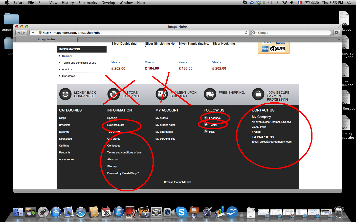

imagenoire Posted November 28, 2013 Share Posted November 28, 2013 Dear friends, could someone please tell me how to edit (or remove) that big block on the main page and how to remove pictograms in it. Please see screen shot attached. Thank you in advance, Victor Link to comment Share on other sites More sharing options...
Rolige Posted November 28, 2013 Share Posted November 28, 2013 You want to remove the footer only in the home page ? Link to comment Share on other sites More sharing options...
imagenoire Posted November 28, 2013 Author Share Posted November 28, 2013 (edited) You want to remove the footer only in the home page ? I would like to change contact info in it, add social networks etc. Remove pictograms. Edited November 28, 2013 by imagenoire (see edit history) Link to comment Share on other sites More sharing options...
Rolige Posted November 28, 2013 Share Posted November 28, 2013 You can found this module in: modules/blockreinsurancetake a look at the file "blockreinsurance.tpl", here you can edit all html style.Regards. Link to comment Share on other sites More sharing options...

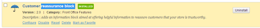

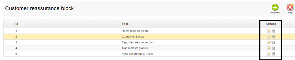

nadie Posted November 28, 2013 Share Posted November 28, 2013 Imagen 1 Tab Modules -> Modules Search Module: reassurance block Image Click configure. Image In the settings you can change texts and images. If you want to do something special, edit the file that you commented Cotoko. Sorry for my English Link to comment Share on other sites More sharing options...
imagenoire Posted November 28, 2013 Author Share Posted November 28, 2013 Thank you so much guys! But what to do with this? How to edit it? Link to comment Share on other sites More sharing options...

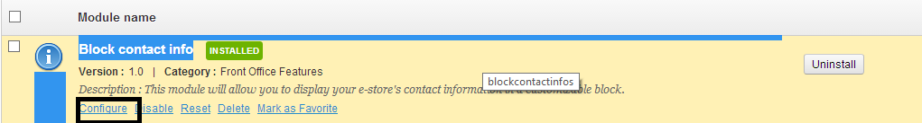

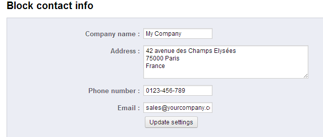

nadie Posted November 28, 2013 Share Posted November 28, 2013 I would like to change contact info Tab Modules -> Modules Search Module Block contact info click configure. Image Image Sorry for my English Link to comment Share on other sites More sharing options...
ibndawood Posted November 28, 2013 Share Posted November 28, 2013 I would like to change contact info in it, add social networks etc. Remove pictograms. Hi Imagenoire, All these are module blocks. If you want to edit them please go to Modules-> Positions and search for displayFooter that will list all the modules hooked to the footer. Modules hooked to footer After that you can got to Modules->Modules and you can search for modules. Click on "Configure" to edit the modules you want. Link to comment Share on other sites More sharing options...

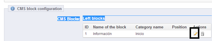

nadie Posted November 28, 2013 Share Posted November 28, 2013 Image Tab modules -> modules Search module: CMS Block Click on configure and you can configure the links shown in the cms block. I add that to remove the following links: "Specials" -> Remove "New Products" -> Remove "Top Sellers" -> Remove "Sitemap" -> Remove Edit file: /themes/your-template/modules/blockcms/blockcms.tpl Sorry for my English Link to comment Share on other sites More sharing options...

imagenoire Posted November 28, 2013 Author Share Posted November 28, 2013 Thank you SO much guys for you help! However i still can't manage to remove three things: PS. concerning "Our stores" thing, i went to Preferences -> CMS and removed what i didn't need. So atm there are only: - delivery - terms and conditions - about us (i deleted those that i didn't want) But if I go on my site, "Our stores" is still there Link to comment Share on other sites More sharing options...

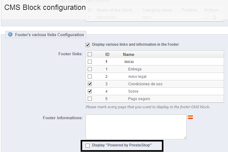

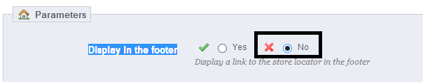

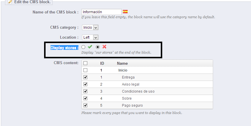

nadie Posted November 28, 2013 Share Posted November 28, 2013 Remove link "our store" blockcms "footer". Tab: Preferences -> Store ContactsOption: Display in the footer -> NO Image Remove link "Stores in the blockcms left column" Tab Modules -> Modules Search: CMS Block Click Configure Search: CMS Blocks: Left blocks Click Edit. Image Now click: Display stores : NO Image Remove: Powered by PrestaShop™ In configuration module CMS Block Remove click option: Display "Powered by PrestaShop" Image Sorry for my English. Remember clear smarty cache in the Advanced Parameters> Performance tab Link to comment Share on other sites More sharing options...
