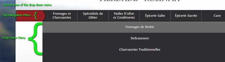

So, when I leave the code untouched the top menu looks like this:

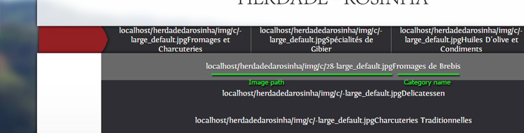

After some tests I reached the following result:
The path to the image is displayed, but not the image. To get to this output I changed the previous code to this:
Link::getCatImageLink($category->link_rewrite, $category->id_image, 'large_default')
Replacing the arrow ( -> ) with the double colon ( :: ) shows that the function is correct and that something else is wrong. I know that one must be used in order to get static members an the other to get instances (making the arrow the correct one to use here), but I had to test the other way around.

Well, I have made a pause on this issue for the last few days and today I decided to get back on it and I found out what the problem was.
I was using the $link variable without it being defined. So I just added $link = new Link(); before $link->getCatImageLink()
$link = new Link();
$this->_menu .= '<li '.$selected.'>';
$this->_menu .= '<a href="'.Tools::HtmlEntitiesUTF8($category_link).'">'.$link->getCatImageLink($category->link_rewrite, $category->id_image, 'large_default').$category->name.'</a>';
The problem now, has you can see in the following image, is that this doesn't displays the images, only their paths.
So, what I did was to get the $link->getCatImageLink() to its own line:
$link = new Link();
$this->_menu .= '<a href="'.Tools::HtmlEntitiesUTF8($category_link).'">'.$category->name.'</a>';
$this->_menu .= '<img src="'.$link->getCatImageLink($category->link_rewrite, $category->id_image, 'large_default').'" alt="" title="" />';
The images did show, but not the way they should:
I only uploaded one subcategory image so far (for Fromages de Brebis), but it displays the same default "?" image that the subcategories that don't have an image defined. The path to the image is correct and I really don't know why it's not displaying it.
Any idea what the problem might be?
  • 2 weeks later...
Ok, so today I got into this problematic again and I found out why the question mark was showing instead of the category images. The path that the getCatImagelink was returning was the correct one, but the image simply didn't show.
Then I changed this
to this
$this->_menu .= '<img src="http://'.$link->getCatImageLink($category->link_rewrite, $category->id_image, 'large_default').'" alt="" title=""/>';
Even if the path was correct, it didn't automatically called the http:/ like it happens on the rest of the site. I find that odd, something must be missing but well, since it's working i'm happy about it. I'll dive into this matter so I can better understand the problem and, if possible, to correct it.
So that's it, we can finally mark it as solved.
