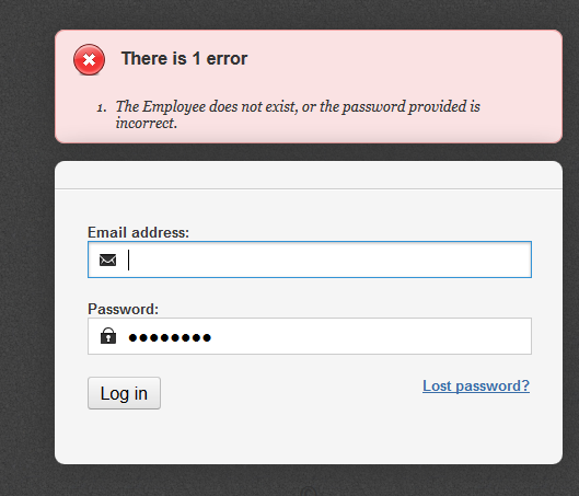

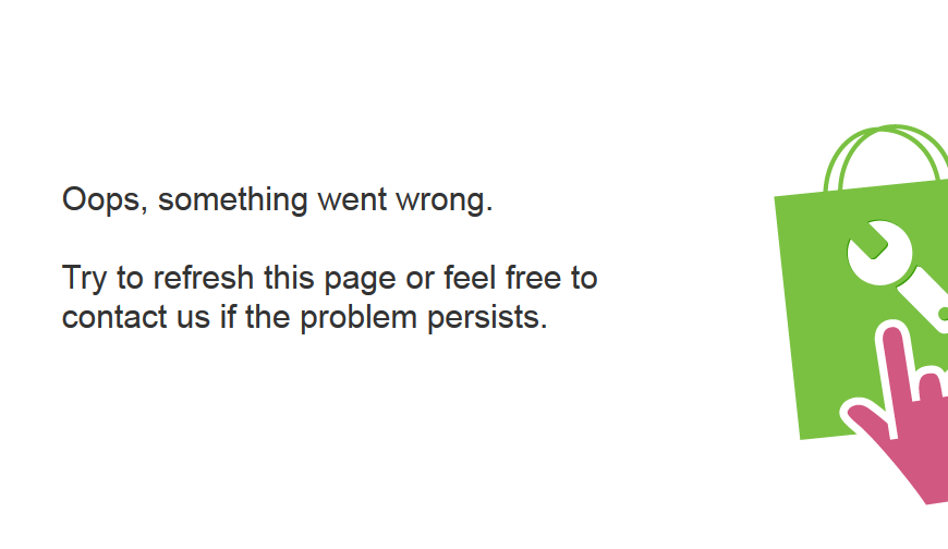

Micamelus Posted November 25, 2013 Author Share Posted November 25, 2013 Here is the Error Message I get. And this is the error message I get when trying to login. Link to comment Share on other sites More sharing options...
Alex Simonchik BelVG Posted November 25, 2013 Share Posted November 25, 2013 Hi, did you change url in `ps_shop_url`? Regards Link to comment Share on other sites More sharing options...
Micamelus Posted November 25, 2013 Author Share Posted November 25, 2013 Hi, did you change url in `ps_shop_url`? Regards I did not. Where is the file that I changed that at? I think that will fix it... Thanks! Link to comment Share on other sites More sharing options...
Alex Simonchik BelVG Posted November 25, 2013 Share Posted November 25, 2013 It is a table in your DB Link to comment Share on other sites More sharing options...
Micamelus Posted November 25, 2013 Author Share Posted November 25, 2013 It is a table in your DB Okay. I have a problem. I logged into MYSQL and launched phpmyadmin through GoDaddy, but there isn't any listed tables under my website. How would I go about importing or populating that field? Or is it better to just change the settings in SEO & URL with WAMP, then re-upload all the files and change the files all, again? Thanks ~ Sorry, I'm new to using PrestaShop. Link to comment Share on other sites More sharing options...
Alex Simonchik BelVG Posted November 25, 2013 Share Posted November 25, 2013 You can import/export DB with phpMyAdmin Link to comment Share on other sites More sharing options...
benjamin utterback Posted November 25, 2013 Share Posted November 25, 2013 You should export the database from your local install (given that nothing has changed in the database from the time you uploaded your PrestaShop files to your live site) and then import the database into your live host. Then, Go to the table "ps_configuration" and locate the records for PS_SHOP_DOMAIN and PS_SHOP_DOMAIN_SSL. Change these to the new domain name. Check the configuration table for any other entries that contain the old domain name and change accordingly. 1 Link to comment Share on other sites More sharing options...
