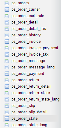

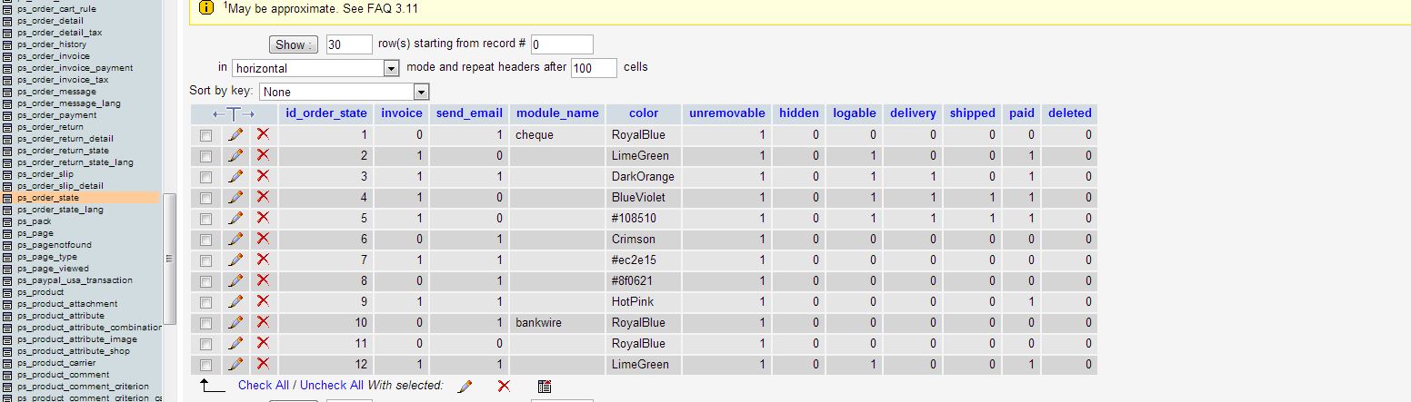

Is this different ps_order_state?  Picture is attached.
Why would PS_OS_PAYMENT be missing?
Thanks again.
Thanks again.

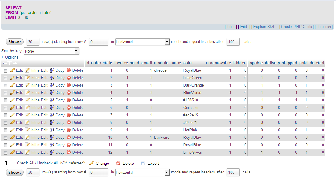

PS_OS_PAYMENT
Does Not exist in my database, either nor can I find the code which creates this.
Makes me wonder which version of PS goes this comes from El Patron.

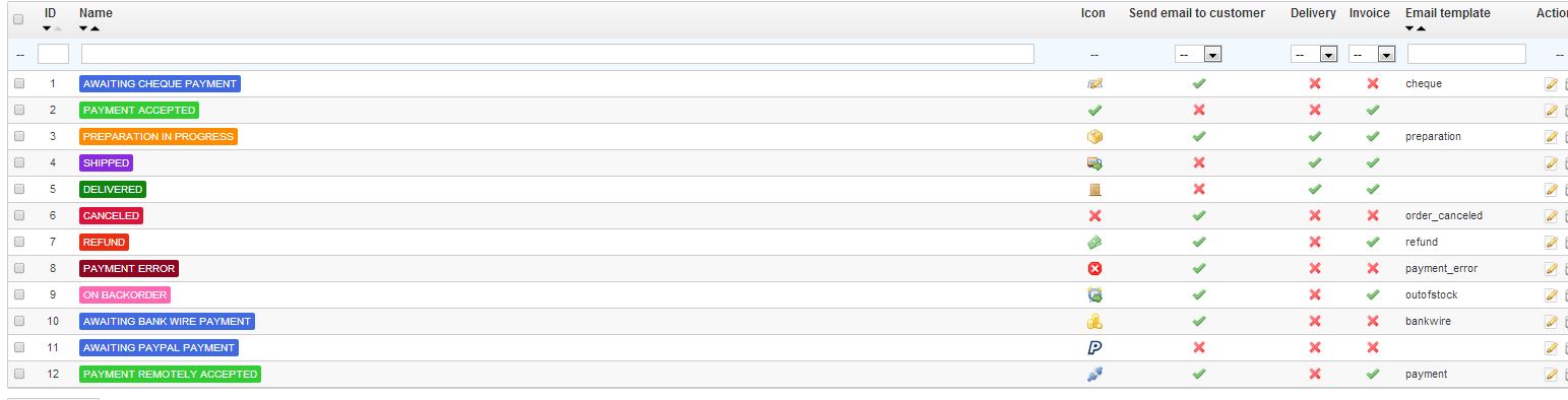

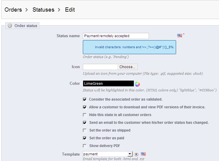

What I do see in Orders > Statuses is #11 Awaiting PayPal Payment all XXX out.
 I am wondering if this the way it is designed to be or is there some switch needed to be set or does the Payment remotely accepted take care of PayPal?
Maybe El Patron you can look at your settings and shed some light on this.

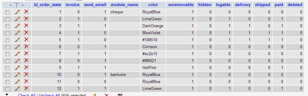

PS_OS_PAYMENT
attachicon.gifps_order.png    attachicon.gifpsorderstate.png   attachicon.gifPayment remotely accepted.png
That was my next question.  Our db tables look like yours.  Which version of PS are you using?

I looked back at two earlier versions of PS and nowhere in the DB can you find a stand alone table for PS_OS_PAYMENT
It must be some well kept secret so I guess I'll just rummage through the code to se what I can find...

Not sure what you are looking at when you say you 'can't' find what PS_OS_PAYMENT.
btw: For me anyway the coffee is 'never' bad.  Currently have a nice med turtle latte, extra hot, soy, no whip with extra shot. :)
HERE IS 1.5.6.1 (but this is true for many earlier versions of PrestaShop)

Now the 1.5.6.1 native MYSQL DB
http://screencast.com/t/uUkhkpqv42
