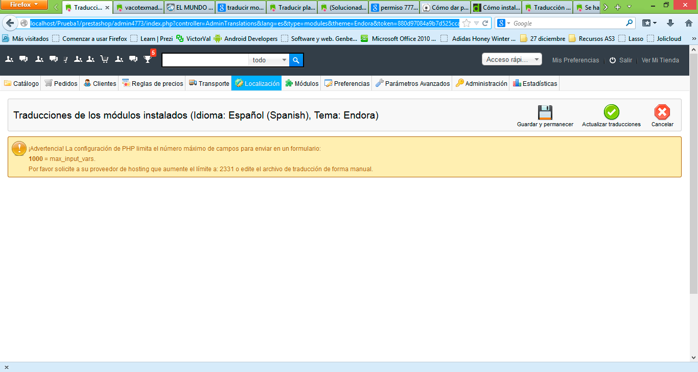

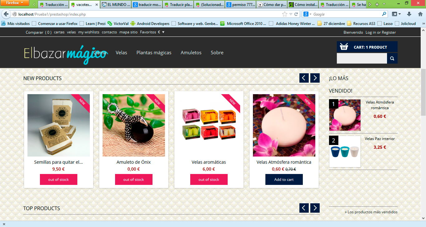

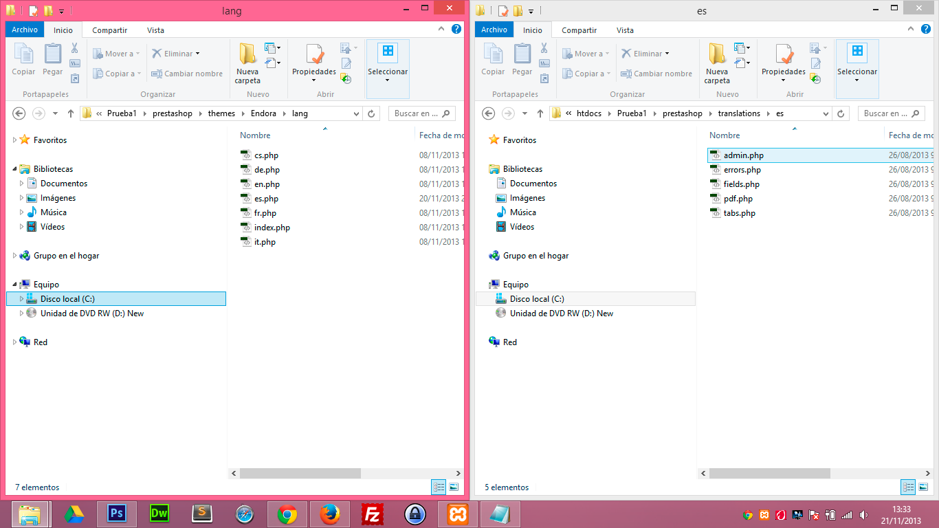

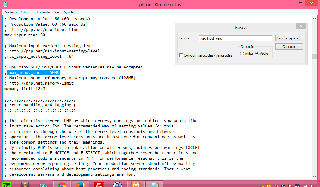

cartuyas Posted November 21, 2013 Share Posted November 21, 2013 Good afternoon, I am new to this and it is an emerging problem that I'm unable to solve.Also I did not answer from the forum template. I have searched google and no solution has helped me. I am using Xampp and my Prestashop version is 1.5.5.0; My Web Server Version: Apache/2.4.4 (Win32) PHP/5.4.19 OpenSSL/0.9.8y I need to translate to Spanish some titles of the modules installed in my template Endora themeforest. ( screenshot2 attached ) and when I try to do (Location -> Translate messages -> Translations installed modules -> Template Endora -> Spanish Flag) shows me a warning message: ( screenshot1 attached ) . So I modified the php.ini: ( screenshot3 attached ) By modifying the php.ini let me modify the frontend but I jump the same error when I select 'Translations of the installed modules.' In turn, when I change the frontend, I seek the literal translation of the title of the module if not translated properly, and does not appear. Attached files both within Prestashop translations as translations files within the template (Endora) if miss any.( screenshot4 attached ) Have also created a new php.ini file with max_input_vars value = 5000, and has not worked. Thank you very much in advance, I hope you help me to solve my problem. Regards Link to comment Share on other sites More sharing options...
vekia Posted November 21, 2013 Share Posted November 21, 2013 hello, your issue related to max input vars isn't prestashop issue. increase your max_input_vars option limit on your hosting (php.ini) more informations about this you can read here: max_input_vars and prestashop Link to comment Share on other sites More sharing options...
NemoPS Posted November 22, 2013 Share Posted November 22, 2013 You forgot to remove the ; before that max input vars it means it's still commented out! Link to comment Share on other sites More sharing options...
