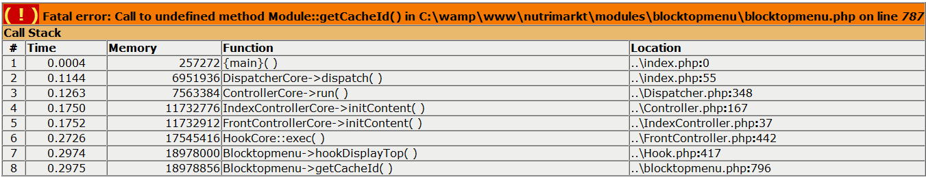

vekia Posted December 6, 2013 Share Posted December 6, 2013 what you see instead of shop? white page? if so, please turn on error reporting, will see then where the problem is Link to comment Share on other sites More sharing options...
joaofilipe Posted December 6, 2013 Share Posted December 6, 2013 (edited) here´s the error... Edited December 15, 2013 by joaofilipe (see edit history) Link to comment Share on other sites More sharing options...
vekia Posted December 6, 2013 Share Posted December 6, 2013 ahh you use 1.5.3 there is no cache support for modules. can you try with this file: http://pastebin.com/sk2RmBJg it's a blocktopmenu.php - copy it to module directory (overwrite original file) 1 Link to comment Share on other sites More sharing options...
joaofilipe Posted December 6, 2013 Share Posted December 6, 2013 Thanks again vekia, working now. I just have to find where i can align the menu to left because it run away to right! Do you know where can i change the name All manufacturers to any i want? Link to comment Share on other sites More sharing options...
