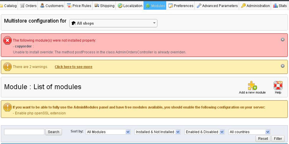

gowri Posted November 15, 2013 Author Share Posted November 15, 2013 Hi Vekia, First of all Thanks for your response. Yes. You are right, but the modules are for different purpose,and the method (ie postprocess()) in admin order controller is used for both of the modules. So while installing the second module, i got the error as "Unable to install Override : The Method postprocess() in the class AdminOrdersController is already overridden". I want to get clear in two points, 1. If we use the same method for override in a controller from different modules, what is the exact solution ? 2. for postprocess() in adminordercontroller, is there any possible alternate method to use? If possible Please reply me... Thanks in advance Link to comment Share on other sites More sharing options...
vekia Posted November 15, 2013 Share Posted November 15, 2013 1) there is no way to use two overrides as Nemo1 stated above. 2) what kind of code you want to use? i convinced that you can create only one override, which will be used by two separate modules. Link to comment Share on other sites More sharing options...
