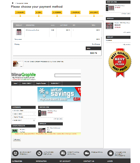

ishkey Posted November 21, 2013 Share Posted November 21, 2013 (edited) Taxes fixed still the other problems and now paypal returns my main page to the iframe see below found 3 payment errors in bo - "Field format error: Secure Token Not found" The error ones sent a canned email. Your order with the reference NHJGHYJMU - Payment processing erroror Edited November 21, 2013 by ishkey (see edit history) Link to comment Share on other sites More sharing options...
