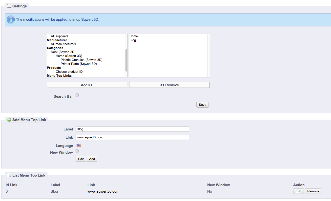

lari Posted November 8, 2013 Author Share Posted November 8, 2013 Nemo,Q1. Where would I change the home category? I can't seem to find a way to do that. Q2. Yes, I did this and it does not work because it adds "http://store.sqwert3d.com/en" before the domain link I entered. If you click the "Blog" link on my website you will see that it doesn't work. Please see screenshot for details I entered. Help! Link to comment Share on other sites More sharing options...

vekia Posted November 8, 2013 Share Posted November 8, 2013 2) you have to use full url not simple: "sqwert3d.com" i mean that you have to use: "http://sqwert3d.com" 2 Link to comment Share on other sites More sharing options...
lari Posted November 9, 2013 Author Share Posted November 9, 2013 THANK YOU so much! You are a lifesaver, and it was such an easy fix! 1 Link to comment Share on other sites More sharing options...
