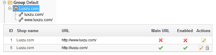

T_Gu3 Posted October 31, 2013 Author Share Posted October 31, 2013 check this-->back office-->preferences--seo & urls scroll down to shop domain names Change the domains names so they do not have the 'www' and retest. When I visited your site I get the domain url without the 'www'. In your error message I see the domain name with the 'www' Thanks for your response. Sorry I forgot to mention that our instance of PrestaShop is a multistore configuration so I couldn't see anywhere to remove the 'www' at Preferences-->SEO & URLs only at Advanced Parameters-->Multistore. I attached an image showing what I've done, is this correct? Link to comment Share on other sites More sharing options...
El Patron Posted October 31, 2013 Share Posted October 31, 2013 edit enabled shop, id 5, and add the www to the url. also you should turn off errors as this can cause unpredictable results with cart... btw: nice shop! Link to comment Share on other sites More sharing options...
