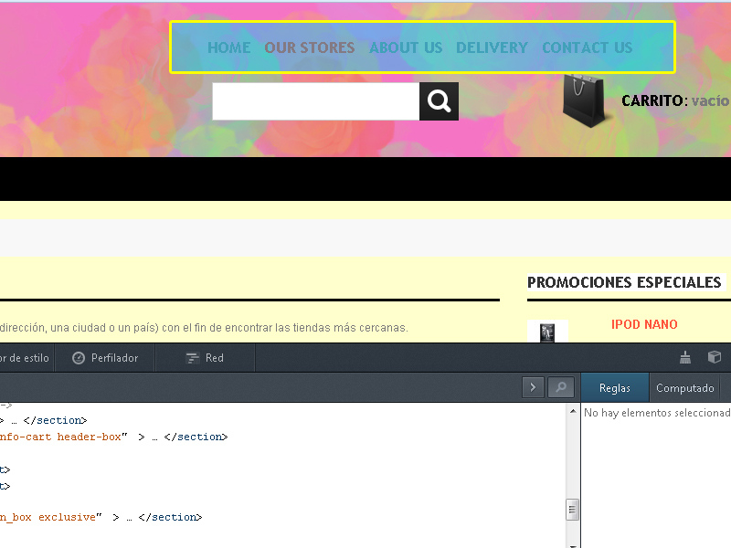

icaro87 Posted October 27, 2013 Author Share Posted October 27, 2013 (edited) hola mira es esteque esta encerrado en un recuadro amarillo a la version que uso de prestashop es "prestashop_1.5.6.0" y la plantilla se llama "theme593" Edited October 27, 2013 by icaro87 (see edit history) Link to comment Share on other sites More sharing options...

nadie Posted October 27, 2013 Share Posted October 27, 2013 Ok ,veo que en tu fichero: /theme593/modules/blockpermanentlinks/blockpermanentlinks-header.tpl Tienes esto: <ul id="header_links"> <li><a href="{$link->getPageLink('index.php')}" class="header_links_home">{l s='home' mod='blockpermanentlinks'}</a></li> <li><a href="{$link->getPageLink('stores')}" class="header_links_store">{l s='Our stores'}</a></li> <li ><a href="{$link->getCMSLink('4', 'About Us')}" class="header_links_about">{l s='About Us'}</a></li> <li ><a href="{$link->getCMSLink('1', 'Delivery')}" class="header_links_delivery">{l s='Delivery'}</a></li> <li><a href="{$link->getPageLink('contact', true)}" class="header_links_contact" title="{l s='Contact us' mod='blockpermanentlinks'}">{l s='Contact us' mod='blockpermanentlinks'}</a></li> </ul> ¿no? Link to comment Share on other sites More sharing options...
nadie Posted October 27, 2013 Share Posted October 27, 2013 Ok ,veo que en tu fichero: /theme593/modules/blockpermanentlinks/blockpermanentlinks-header.tpl Tienes esto: <ul id="header_links"> <li><a href="{$link->getPageLink('index.php')}" class="header_links_home">{l s='home' mod='blockpermanentlinks'}</a></li> <li><a href="{$link->getPageLink('stores')}" class="header_links_store">{l s='Our stores'}</a></li> <li ><a href="{$link->getCMSLink('4', 'About Us')}" class="header_links_about">{l s='About Us'}</a></li> <li ><a href="{$link->getCMSLink('1', 'Delivery')}" class="header_links_delivery">{l s='Delivery'}</a></li> <li><a href="{$link->getPageLink('contact', true)}" class="header_links_contact" title="{l s='Contact us' mod='blockpermanentlinks'}">{l s='Contact us' mod='blockpermanentlinks'}</a></li> </ul> ¿no? Lo primero de de todos los literales corrigelos, para dejarlos asi: <ul id="header_links"> <li><a href="{$link->getPageLink('index.php')}" class="header_links_home">{l s='home' mod='blockpermanentlinks'}</a></li> <li><a href="{$link->getPageLink('stores')}" class="header_links_store">{l s='Our stores' mod='blockpermanentlinks'}</a></li> <li ><a href="{$link->getCMSLink('4', 'About Us')}" class="header_links_about">{l s='About Us' mod='blockpermanentlinks'}</a></li> <li ><a href="{$link->getCMSLink('1', 'Delivery')}" class="header_links_delivery">{l s='Delivery' mod='blockpermanentlinks'}</a></li> <li><a href="{$link->getPageLink('contact', true)}" class="header_links_contact" title="{l s='Contact us' mod='blockpermanentlinks'}">{l s='Contact us' mod='blockpermanentlinks'}</a></li> </ul> Link to comment Share on other sites More sharing options...

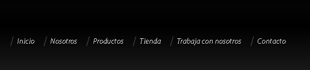

icaro87 Posted October 27, 2013 Author Share Posted October 27, 2013 asi megustaria dejarlo, pero me di cuenta que editando el codigo .tlp, puedo hacerlo Link to comment Share on other sites More sharing options...
nadie Posted October 27, 2013 Share Posted October 27, 2013 Vamos a imaginar que trabaja con nosotros es un enlace a un contenido que has creado en la pestaña Preferencias -> CMS, entonces dentro del: <ul id="header_links"> añadirias esto: <li><a href="{$link->getCMSLink('id_de_cms', null)}" class="header_links_about">{l s='Trabaja con nosotros' mod='blockpermanentlinks'}</a></li> Donde id_del_cms sera el id del cms donde quieres linkar el enlace. (El id puedes verlo en la pestaña Preferencias -> CMS) Luego, si tienes varios idiomas activados en la tienda la palabra: Trabaja con nosotros La puedes traducir en la pestaña Localizacion -> Traducciones -> Traducciones de los modulos. Link to comment Share on other sites More sharing options...
