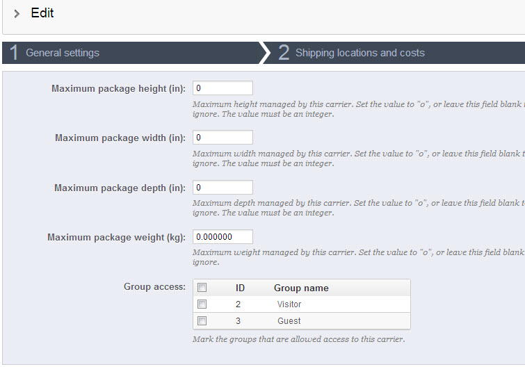

ragnabt Posted November 2, 2013 Author Share Posted November 2, 2013 (edited) Hi No, i didn´t think it was a theme based problem :/ But in my poor effort to try to fix it i edited all my carriers and sat the checkboxes on the group access to active, I thought maybe it was because of that but then all of my carriers dissapeared in the checkout. I removed the checkboxes again on the group access but no luck, carriers didn´t show up again so I cant test the payment... or activate my shop until then Any ideas what that is about? Edited November 2, 2013 by ragnabt (see edit history) Link to comment Share on other sites More sharing options...

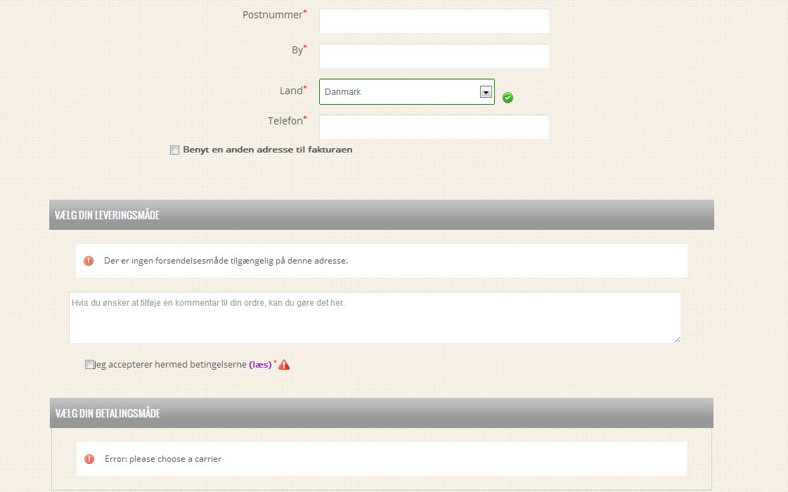

ragnabt Posted November 3, 2013 Author Share Posted November 3, 2013 Just tried with the standard checkout module but the same thing, no shipping showing Link to comment Share on other sites More sharing options...
ragnabt Posted November 3, 2013 Author Share Posted November 3, 2013 somehow it doesnt count any carriers. I debugged a little and it says 0 carriers Link to comment Share on other sites More sharing options...
