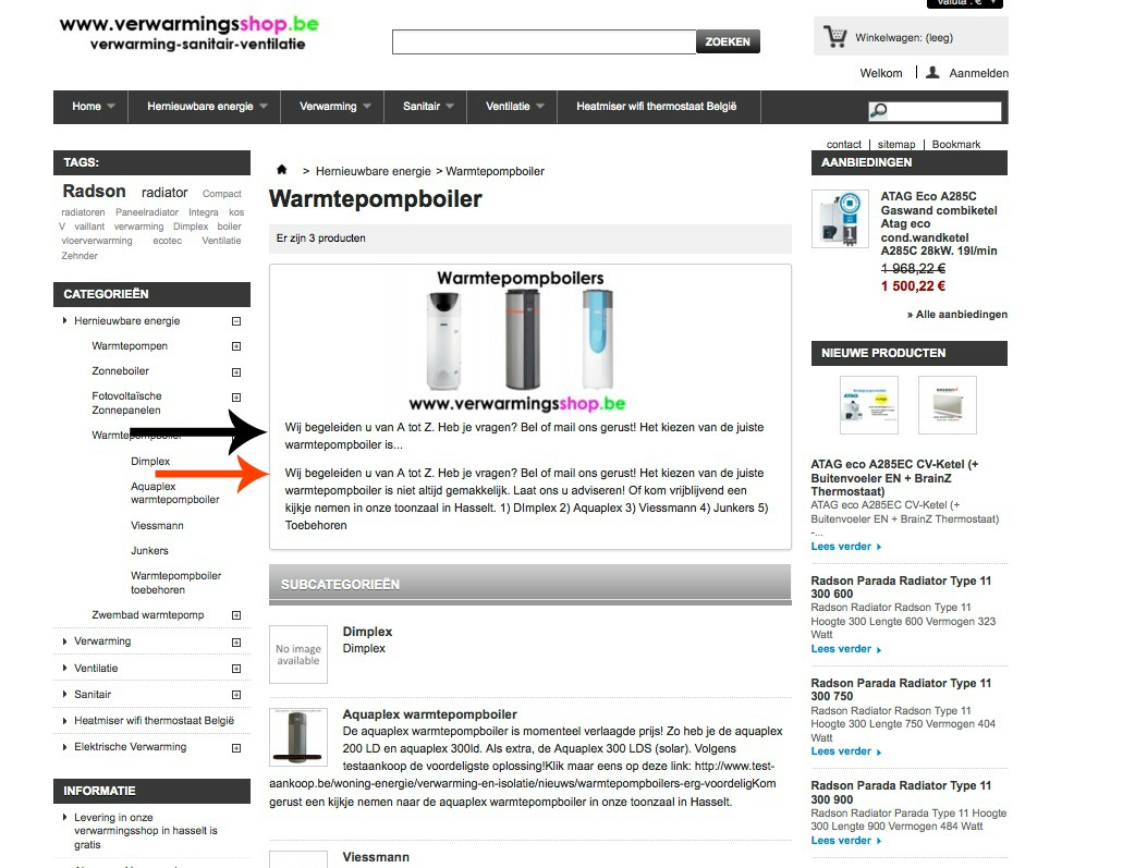

Optimus_Sam Posted October 25, 2013 Share Posted October 25, 2013 (edited) Hi guys, I'm using ps 1.5.5.0 with the default theme on verwarmingsshop.be And the problem is that my category and sub menu's are shown "double" on the pages... Can someone help me out with this? I'll add a screenshot so you guys can see what i mean And here is a link to that webpage, but it gives the same problem on and off on other pages... Thanks! Optimus Edited November 16, 2013 by Optimus_Sam (see edit history) Link to comment Share on other sites More sharing options...
Optimus_Sam Posted October 25, 2013 Author Share Posted October 25, 2013 I mean, in BO it looks normal. But on the webpage, it sometimes shows double... And also the pictures are messed up, showing doubles sometimes Link to comment Share on other sites More sharing options...

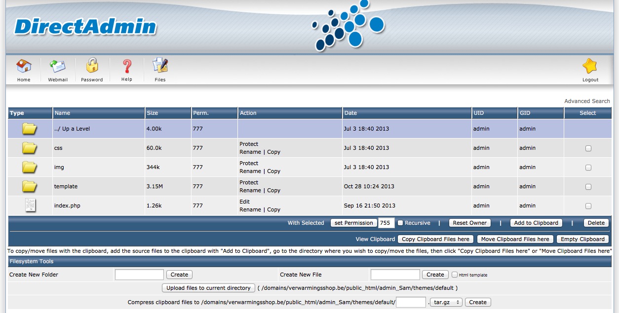

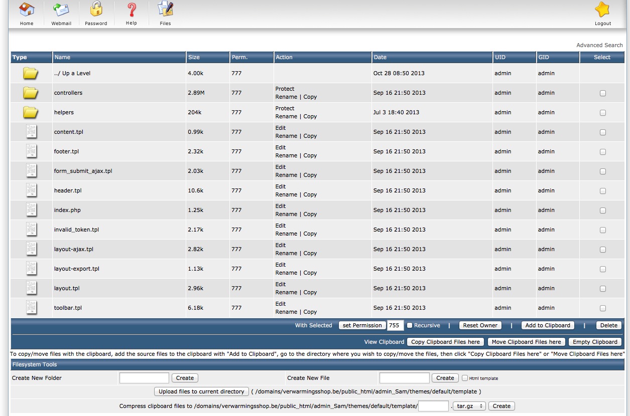

Optimus_Sam Posted October 28, 2013 Author Share Posted October 28, 2013 (edited) Thanks Vekia, here are the attachments. If you can't find anything i'll give you my login for Direct Admin. Edited October 28, 2013 by Optimus_Sam (see edit history) Link to comment Share on other sites More sharing options...

vekia Posted October 29, 2013 Share Posted October 29, 2013 are you sure that this is structure of theme located in your prestashop installation directory? it looks a bit different than presteshop filesystem Link to comment Share on other sites More sharing options...
