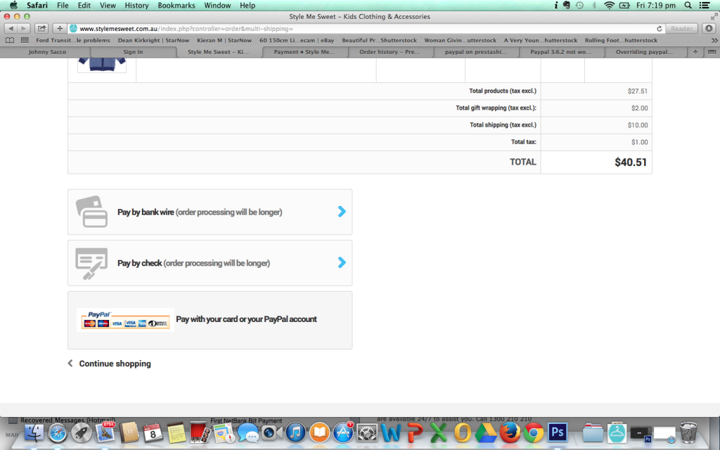

Example when i get to this point in the process and i click on the paypal payment button nothing happens.. I'm using the euro version of paypal but I'm based in Australia not sure if that could be the reason.
ScreenShot2014-08-08at71914pm_zps8e5fed9
I really need to get paypal working on this site, i sorta shattered that paypal does not naturally integrate  with prestashop.
I was hesitant to buy the pro version of paypal since i am running the new version of prestashop just incase its not compatible.

Thanks for sharing the issue.  May I know if the issue has been resolved and what the solution is?
My business is also based in Australia.  We are using PS1.6 at the moment and our site is still under construction.  I would greatly appreciate if someone could let me know if PayPal Express or PayPal Standard (I do not wish to use PayPal Pro) works on PS1.6.  Thanks in advance.
yes paypal works but some have issues but majority do not.  I see that PayPal EU has better success rate than PayPal north America.

we can dust this off if you want to give it another try.  When you stated it did not work, was it that you clicked paypal but it did not leave page?  Can you uninstall and then reinstall paypal and try again?
Yes it does not leave the page at all! i tried uninstalling and reinstalling multiple times! but still did not work! =_=
Hi risk1710, My online business is based in Australia too and going through the process of installing PayPal.  My dedicated PayPal Account Exec is getting their Integration team to help with the installation and integration.  I thought you might like to know about this free PayPal integration resource just in case.  Cheers.
I'm using PayPal v3.7.2 version.
The PayPal Integration Engineer has just integrated the module for me and it works (After 2 attempts), I choose the Express Checkout Solution under the PayPal v3.7.2 version.  Apparently, the Shipping/Carriers module in PrestaShop affects the working of the PayPal button.  We have to properly configure the Shipping/Carriers module for the PayPal button to work.
PrestaShop split the original  'free' PayPal module into:
1. PayPal USA/Canada/Mexico
requires proper shop localization-->localization-->see advance-->country identifier (tip: don't change as can cause unpredictable results and downtime).
2. PayPal EU - is everywhere outside of USA/Canada/Mexico
checks shop country localization warning at install for non-->USA/Canada/Mexico
v.3.7.2 as my shop is localized US, module config allowed me to change, I set to Australia.
