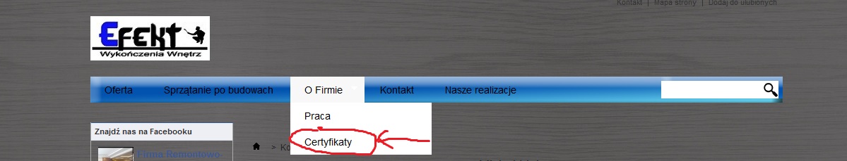

masimo Posted October 24, 2013 Author Share Posted October 24, 2013 "O firmie" ma ID = 8 . Jeśli ma to jakieś znaczenie dam screena o co mi dokładnie chodzi . Chcę z tego jednego linku "Certyfikaty" (tak jak na screenie) zrobić własny link . Link to comment Share on other sites More sharing options...
vekia Posted October 24, 2013 Share Posted October 24, 2013 aahh to zatem nie ma to być dla zakładki O firmie, tylko dla "certyfikatów" w tym przypadku trzeba będize wyedytować inny fragment: foreach ($pages as $page) { $cms = new CMS($page['id_cms'], (int)$id_lang); $links = $cms->getLinks((int)$id_lang, array((int)$cms->id)); $selected = ($this->page_name == 'cms' && ((int)Tools::getValue('id_cms') == $page['id_cms'])) ? ' class="sfHoverForce"' : ''; $this->_menu .= '<li '.$selected.'>'; $this->_menu .= '<a href="'.$links[0]['link'].'">'.$cms->meta_title.'</a>'; $this->_menu .= '</li>'; } na: foreach ($pages as $page) { $cms = new CMS($page['id_cms'], (int)$id_lang); $links = $cms->getLinks((int)$id_lang, array((int)$cms->id)); $selected = ($this->page_name == 'cms' && ((int)Tools::getValue('id_cms') == $page['id_cms'])) ? ' class="sfHoverForce"' : ''; $this->_menu .= '<li '.$selected.'>'; if ($links[0]['id_cms']==7){ $this->_menu .= '<a href="MOJ_LINK_DO_STRONY">'.$cms->meta_title.'</a>'; } else { $this->_menu .= '<a href="'.$links[0]['link'].'">'.$cms->meta_title.'</a>'; } $this->_menu .= '</li>'; } 1 Link to comment Share on other sites More sharing options...
