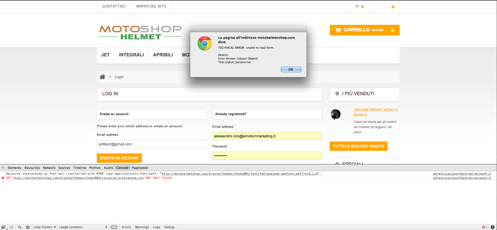

KolfKord Posted October 23, 2013 Share Posted October 23, 2013 (edited) Hello everyone, I shot for the entire board with similar errors but have not arrived at a solution ... It always fails to re-register as image ... Please help! Edited October 26, 2013 by KolfKord (see edit history) Link to comment Share on other sites More sharing options...
vekia Posted October 23, 2013 Share Posted October 23, 2013 please share url to your website i will inspect whole order process. it's necessary to turn on browser console log to see what's goin on with ajax queries there Link to comment Share on other sites More sharing options...
KolfKord Posted October 24, 2013 Author Share Posted October 24, 2013 Thanks for the reply vekia, here is the link: http://motohelmetshop.com/presta/it/ Link to comment Share on other sites More sharing options...
vekia Posted October 24, 2013 Share Posted October 24, 2013 please turn on CCC for js files under adv. paramters > perfromance tab in your back office, it looks like the problem is related to this. Then i will inspect code once again Link to comment Share on other sites More sharing options...
KolfKord Posted October 24, 2013 Author Share Posted October 24, 2013 is already set up on ... please let send you a private message with the coordinates of the control panel ... Link to comment Share on other sites More sharing options...
vekia Posted October 24, 2013 Share Posted October 24, 2013 thank you, so im going to check it Link to comment Share on other sites More sharing options...
vekia Posted October 24, 2013 Share Posted October 24, 2013 ok i checked it: JSMin: Unterminated String at byte 176: "<br />{"hasError":false,"errors":[],"page":"<div class=\"breadcrumb\"><div class=\"b it's because of <br /> do you remember where you add this html tag? Link to comment Share on other sites More sharing options...

vekia Posted October 24, 2013 Share Posted October 24, 2013 can you verify it right now please? Link to comment Share on other sites More sharing options...
KolfKord Posted October 24, 2013 Author Share Posted October 24, 2013 Yeah!! It works THANKSS! But so that red box? attached Link to comment Share on other sites More sharing options...
