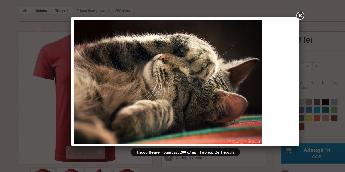

kokosmin Posted October 16, 2014 Share Posted October 16, 2014 Thank you, that works. I set this up for images. I see 3 settings for auto-size, but puting them all to „true” doesn't wrap the fancybox near the image. Pic attached. And link http://fabricadetricouri.ro/2015/tricouri/8-tricou-heavy-new-bumbac-200-gmp.html Link to comment Share on other sites More sharing options...
skechav Posted October 16, 2014 Share Posted October 16, 2014 On 10/16/2014 at 12:13 PM, kokosmin said: Thank you, that works. I set this up for images. I see 3 settings for auto-size, but puting them all to „true” doesn't wrap the fancybox near the image. Pic attached. And link http://fabricadetricouri.ro/2015/tricouri/8-tricou-heavy-new-bumbac-200-gmp.html Kokosmin, while i was writting this post as I see that you finally corrected your javascript code. Your code didnt have width and height set before. Now I see it is working fine. Link to comment Share on other sites More sharing options...
skechav Posted October 16, 2014 Share Posted October 16, 2014 On 10/16/2014 at 2:46 PM, skechav said: Kokosmin, while i was writting this post as I see that you finally corrected your javascript code. Your code didnt have width and height set before. Now I see it is working fine. But with settings set to true and without using a new CMS page to keep your sizechart inside...check your page for a minute with Chrome browser... 1 Link to comment Share on other sites More sharing options...
kokosmin Posted October 16, 2014 Share Posted October 16, 2014 On 10/16/2014 at 2:51 PM, skechav said: But with settings set to true and without using a new CMS page to keep your sizechart inside...check your page for a minute with Chrome browser... Oh, snap. After a few refresh it appeared.. The message is Resource interpreted as Document but transferred with MIME type image/png: "http://fabricadetricouri.ro/2015/img/cms/137.png I hope this resource would help me http://stackoverflow.com/questions/13985003/resource-interpreted-as-document-but-transferred-with-mime-type-image-jpeg That is, adding "type": "image" in the code. Link to comment Share on other sites More sharing options...
