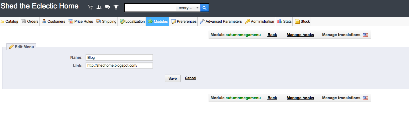

holliej0 Posted October 22, 2013 Share Posted October 22, 2013 I am using a theme called Autumn which uses a module called Autumn Mega Menu for the top navigation, and I want one of the navigation links to open in a new window, but the module doesn't allow me to add any "_blank" html code. See attached for screenshot. Does anybody know how I can do this with one of my top navigation links using this module? Thanks! Link to comment Share on other sites More sharing options...

holliej0 Posted October 22, 2013 Author Share Posted October 22, 2013 Yes, that's all that appears on the module configuration page. If I have to hard code the link, what file do I do this in and where exactly in the file? Since the other navigation links are using this module, I don't want to screw things up. Link to comment Share on other sites More sharing options...

holliej0 Posted October 24, 2013 Author Share Posted October 24, 2013 There is nowhere I can add that simple html in the module that controls the menu - see screenshot attached. Link to comment Share on other sites More sharing options...
Carolina Custom Designs Posted October 24, 2013 Share Posted October 24, 2013 There is nowhere I can add that simple html in the module that controls the menu - see screenshot attached. You will need to add it to the module tpl. (see Nemo1's post above) Marty Shue Link to comment Share on other sites More sharing options...
