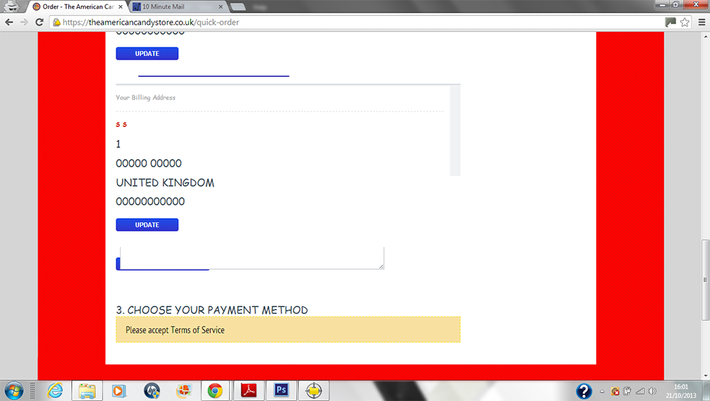

TACS Posted October 19, 2013 Share Posted October 19, 2013 Hello All, this is my first topic here, most of my other bugs i have managed to fix just by reading through the very helpful topics here so, I am hoping that someone can come to my rescue and help me with this bug I have. Basically as the topic says I have a problem with my OPC everything is overlapping and I am not sure what I need to do to fix it, I have checked that all the files are there and I have also replaced them all one by one with another download from prestas previous versions. I figured the best thing I could do at this point was upload some screenshots for you guys to take a look at and hopefully someone will have a solution Thanks In advance for your much needed help! Link to comment Share on other sites More sharing options...

vekia Posted October 21, 2013 Share Posted October 21, 2013 weirdy, i can't reproduce your issue: what browser you use? Link to comment Share on other sites More sharing options...
vekia Posted October 21, 2013 Share Posted October 21, 2013 UPDATE: i see it, it appears only when customer is logged id. im working on it 1 Link to comment Share on other sites More sharing options...
vekia Posted October 21, 2013 Share Posted October 21, 2013 #order-opc div.opc-main-block { position: relative; } remove position:relative; code above is a part of: https://theamericancandystore.co.uk/themes/justshoes/css/order-opc.css line 66 Link to comment Share on other sites More sharing options...

TACS Posted October 21, 2013 Author Share Posted October 21, 2013 Fab! thats made it look a lot better but only thing is I still have a little bit overlapping going on though =/ Thanks for your help with this too Vekia Link to comment Share on other sites More sharing options...
vekia Posted October 21, 2013 Share Posted October 21, 2013 can you share some screenshot what's goin on now? i can't reproduce it (i dont know where to check ) Link to comment Share on other sites More sharing options...

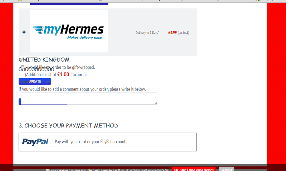

TACS Posted October 21, 2013 Author Share Posted October 21, 2013 can you share some screenshot what's goin on now? i can't reproduce it (i dont know where to check ) For some strange reason I cant find where to attach pictures lol it was beneath when I made this post, can find it now though =/ Link to comment Share on other sites More sharing options...
TACS Posted October 21, 2013 Author Share Posted October 21, 2013 I found it more reply options button Link to comment Share on other sites More sharing options...
vekia Posted October 21, 2013 Share Posted October 21, 2013 ok now it's clear add: height: 750px; display: block; to: #lcsmainbody-inner { color: #555; padding: 20px; display: block; margin-bottom: 1em; height: 750px; display: block; } it's a part of https://www.theamericancandystore.co.uk/themes/justshoes/css/lcsglobal.css line 78 Link to comment Share on other sites More sharing options...
TACS Posted October 21, 2013 Author Share Posted October 21, 2013 Hi Vekia, Iv added those two lines of code but nothing appears to have happened =/ Link to comment Share on other sites More sharing options...
vekia Posted October 21, 2013 Share Posted October 21, 2013 where you pasted this code? i can't find it Link to comment Share on other sites More sharing options...
TACS Posted October 21, 2013 Author Share Posted October 21, 2013 #lcsmainbody-inner { color: #555; padding: 20px; margin-bottom: 1em;} #right_column { ; margin-top: 0em; width: 250px; height: 750px; display: block; on lines 83 + 84 Link to comment Share on other sites More sharing options...
vekia Posted October 21, 2013 Share Posted October 21, 2013 this isn't code that i suggested to use Link to comment Share on other sites More sharing options...
TACS Posted October 21, 2013 Author Share Posted October 21, 2013 (edited) now Im really confused... I went to the link of the lcsglobalcss that you provided, I searched for #lcsmainbody-inner and the code that was there is what iv just pasted up by there, its the same code your referring too and all iv done is add the two lines of code to the end like you suggested =/ should the code be exactly what you have pasted there? because if so it would be a little more than adding just the two lines.. this is how the code was before I adjusted it to add the two lines (as i have kept backups) #lcsmainbody-inner { color: #555; padding: 20px; margin-bottom: 1em;} #right_column { ; margin-top: 0em; width: 250px; } and with the two lines added it looks like this #lcsmainbody-inner { color: #555; padding: 20px; margin-bottom: 1em;} #right_column { ; margin-top: 0em; width: 250px; height: 750px; display: block; Edited October 21, 2013 by TACS (see edit history) Link to comment Share on other sites More sharing options...
TACS Posted October 21, 2013 Author Share Posted October 21, 2013 was #lcsmainbody-inner { color: #555; padding: 20px; margin-bottom: 1em;} #right_column { ; margin-top: 0em; width: 250px; height: 750px; display: block; now (solved) #lcsmainbody-inner { color: #555; padding: 20px; margin-bottom: 1em; display: block;height: 750px;} #right_column { ; margin-top: 0em; width: 250px; I just put those two lines of code in those grouped styles on the one line and its fixed it, YAY! however, I have one slight small issue now and that should be it then, the problem I have now is the large amount of whitespace at the bottom of the checkout, any idea on that? thanks in advance! Link to comment Share on other sites More sharing options...
vekia Posted October 21, 2013 Share Posted October 21, 2013 sorry for the confusion i was offline, but i've noticed that you solved it regarding to the white space: you can decrease height value in: #lcsmainbody-inner { color: #555; padding: 20px; margin-bottom: 1em; display: block; height: 710px; } 710 is optimal value Link to comment Share on other sites More sharing options...
TACS Posted October 22, 2013 Author Share Posted October 22, 2013 (edited) Hi Vekia, Thats okay and yeah I managed to solve it Thanks for your help and the info! regarding the whitespace, I have tried reducing the height but as i do this thing's begin to overlap again, where i have set it at now (as I changed the font size slightly) is where all of the address text should sit, basically the address and headers are all in the right place beneath the continue shopping button however beneath the addresses where it moves onto delivery methods and payments there seems to be a large white space between them (as well as at the bottom of the page) one other thing i have just noticed is when i add a number of items to the cart it it begins to overlap this 1. ADDRESSES CHOOSE A DELIVERY ADDRESS: USE THE DELIVERY ADDRESS AS THE BILLING ADDRESS. any ideas? Edited October 22, 2013 by TACS (see edit history) Link to comment Share on other sites More sharing options...
