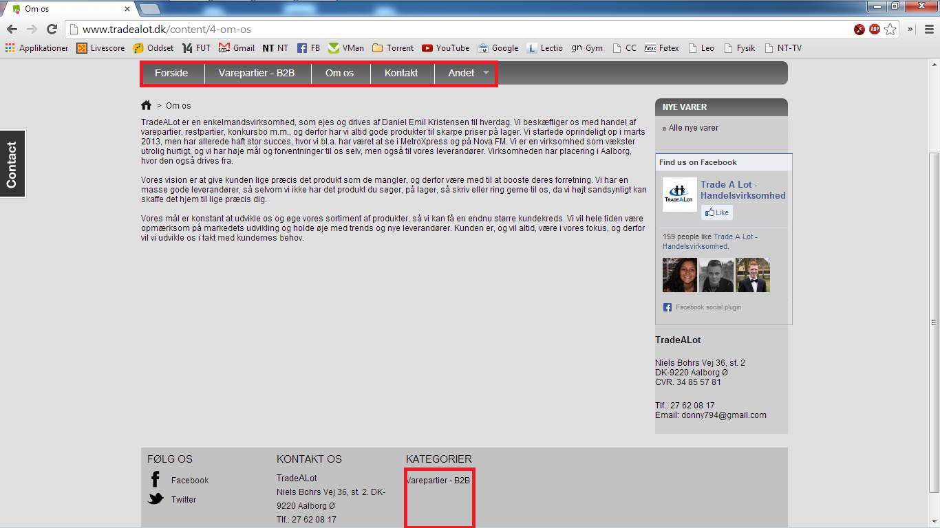

Alexanderleo Posted October 19, 2013 Share Posted October 19, 2013 Hello I am running PS 1.5.5.0 I want the horizontal link menu to be displayed in my footer. I tried to enable the "categories block" but it only shows the products categories. It is possible to show the horizontal links in the footer too? You can see what i mean in my picture. Link to comment Share on other sites More sharing options...

Alexanderleo Posted October 19, 2013 Author Share Posted October 19, 2013 Hello I did what you said but i it is possible to change the view? I want it to be like the other footers. The same setup like "Kategorier" and "Følg os". It looks like this now. Link to comment Share on other sites More sharing options...

Alexanderleo Posted October 19, 2013 Author Share Posted October 19, 2013 If you look in my footer. I got three sections. "Følg os" - "Kontakts os" - "Kategorier". Under the "Kateogier" is says "Varepartier - B2B". I want it to say Forside Varepartier - B2B Om os Kontakt Andet And these should be clickable so you could get to the page. Link to comment Share on other sites More sharing options...

Alexanderleo Posted October 19, 2013 Author Share Posted October 19, 2013 I want the menu points frmo the horizontal menu to be displayed as the other footers? Link to comment Share on other sites More sharing options...
