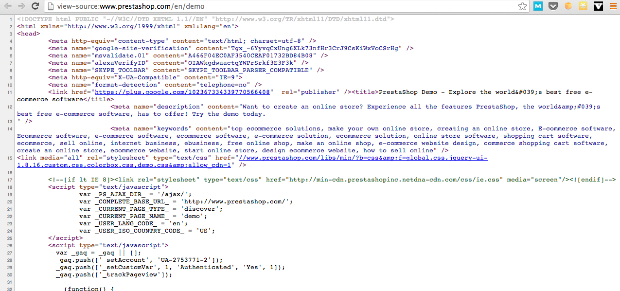

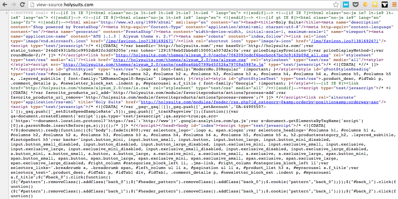

wissammessad Posted October 16, 2013 Share Posted October 16, 2013 Hi, what is the best solution to make your home page source code looks clean? when i say clean, i mean space between tags and attributes like the source code of http://www.prestashop.com/en/demo ( See attached screenshot) view-source:http://www.prestashop.com/en/demo my site and my theme in holysuits.com doesn't have any space between the codes of my home page source code, and to make some space and make it clear. view-source:http://holysuits.com/ Thank you for your support. Wissam Link to comment Share on other sites More sharing options...
wissammessad Posted October 16, 2013 Author Share Posted October 16, 2013 I just found the solution of my problem. the solution is to go to Advanced Parameters > Performance and Change Minify HTML to Keep HTML as original. Link to comment Share on other sites More sharing options...
