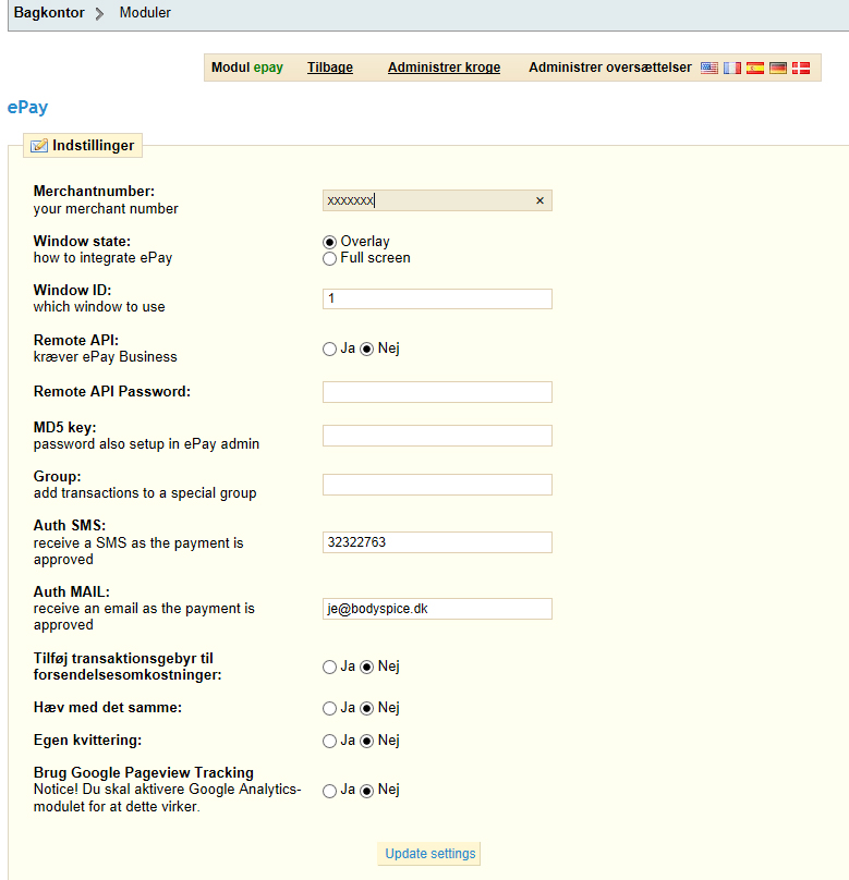

flunte70 Posted October 16, 2013 Author Share Posted October 16, 2013 kan ikke finde dette i epay-modulet? se vedlagte screendump Link to comment Share on other sites More sharing options...
Prestafan1234 Posted October 16, 2013 Share Posted October 16, 2013 Du kan ikke konfigurere dig ud af det. Det skal rettes i tpl-filen der viser kortene. Den ligger under /modules/epay Link to comment Share on other sites More sharing options...
