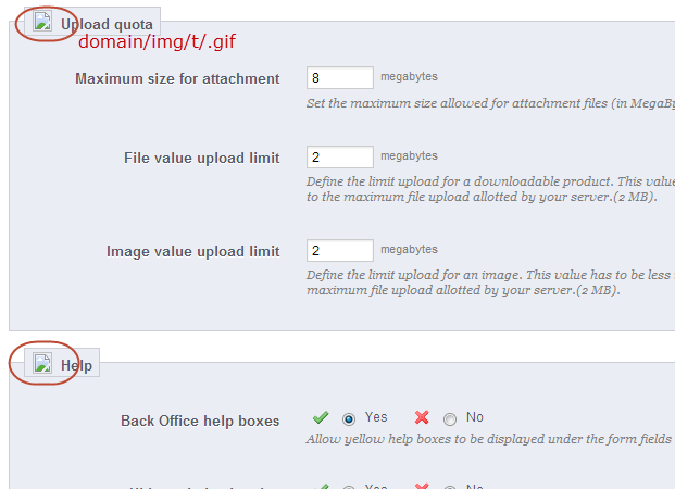

fich Posted October 9, 2013 Share Posted October 9, 2013 (edited) hello.. I'm new on PS. I've installed PS 1.5.6 on my client hosting without error.But I got something wrong on backoffice page, some icons are missing. for example, menu Administration > Preferences, look at Upload quota and Help tabstheir icons are missing.BUT, I've no problem when installed on localhost and my own personal hostingfor information (maybe can help), both client and my hosting are using PHP 5.3.7 and localhost using PHP 5.3.5is there anything I missing?thanks for your help ======== UPDATED ========= when I debug on options.tpl using {print_r($categoryData)} it result Array ( [title] => Upload quota [icon] => tab-preferences [fields] => Array ( [PS_ATTACHMENT_MAXIMUM_SIZE] => Array ( [title] => Maximum size for attachment [desc] => Set the maximum size allowed for attachment files (in MegaBytes). Maximum: 2M [validation] => isInt [cast] => intval [type] => text [suffix] => megabytes [default] => 2 [value] => 8 [is_disabled] => [is_invisible] => [required] => [multishop_default] => ) [PS_LIMIT_UPLOAD_FILE_VALUE] => Array ( [title] => File value upload limit [desc] => Define the limit upload for a downloadable product. This value has to be less than or equal to the maximum file upload allotted by your server.(2 MB). [validation] => isInt [cast] => intval [type] => text [suffix] => megabytes [default] => 1 [value] => 2 [is_disabled] => [is_invisible] => [required] => [multishop_default] => ) [PS_LIMIT_UPLOAD_IMAGE_VALUE] => Array ( [title] => Image value upload limit [desc] => Define the limit upload for an image. This value has to be less than or equal to the maximum file upload allotted by your server.(2 MB). [validation] => isInt [cast] => intval [type] => text [suffix] => megabytes [default] => 1 [value] => 2 [is_disabled] => [is_invisible] => [required] => [multishop_default] => ) ) [image] => ../img/t/.gif [hide_multishop_checkbox] => 1 ) 1 see. $categoryData['image'] = ../img/t/.gif Edited October 21, 2013 by fich (see edit history) Link to comment Share on other sites More sharing options...

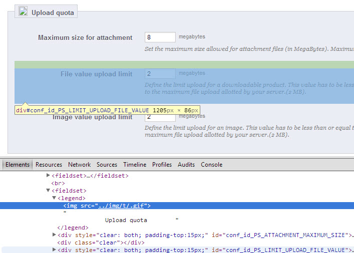

fich Posted October 9, 2013 Author Share Posted October 9, 2013 (edited) yes, I've cheked images folder. there are existsit's look like view .tpl cannot get icon variable from controllerplease see inspect element picture belowthanks for your reply ======== UPDATED ========= when I debug on options.tpl using {print_r($categoryData)} it result Array ( [title] => Upload quota [icon] => tab-preferences [fields] => Array ( [PS_ATTACHMENT_MAXIMUM_SIZE] => Array ( [title] => Maximum size for attachment [desc] => Set the maximum size allowed for attachment files (in MegaBytes). Maximum: 2M [validation] => isInt [cast] => intval [type] => text [suffix] => megabytes [default] => 2 [value] => 8 [is_disabled] => [is_invisible] => [required] => [multishop_default] => ) [PS_LIMIT_UPLOAD_FILE_VALUE] => Array ( [title] => File value upload limit [desc] => Define the limit upload for a downloadable product. This value has to be less than or equal to the maximum file upload allotted by your server.(2 MB). [validation] => isInt [cast] => intval [type] => text [suffix] => megabytes [default] => 1 [value] => 2 [is_disabled] => [is_invisible] => [required] => [multishop_default] => ) [PS_LIMIT_UPLOAD_IMAGE_VALUE] => Array ( [title] => Image value upload limit [desc] => Define the limit upload for an image. This value has to be less than or equal to the maximum file upload allotted by your server.(2 MB). [validation] => isInt [cast] => intval [type] => text [suffix] => megabytes [default] => 1 [value] => 2 [is_disabled] => [is_invisible] => [required] => [multishop_default] => ) ) [image] => ../img/t/.gif [hide_multishop_checkbox] => 1 ) 1 see. $categoryData['image'] = ../img/t/.gifI think it caused by php server configuration, but what? Edited October 9, 2013 by fich (see edit history) Link to comment Share on other sites More sharing options...
