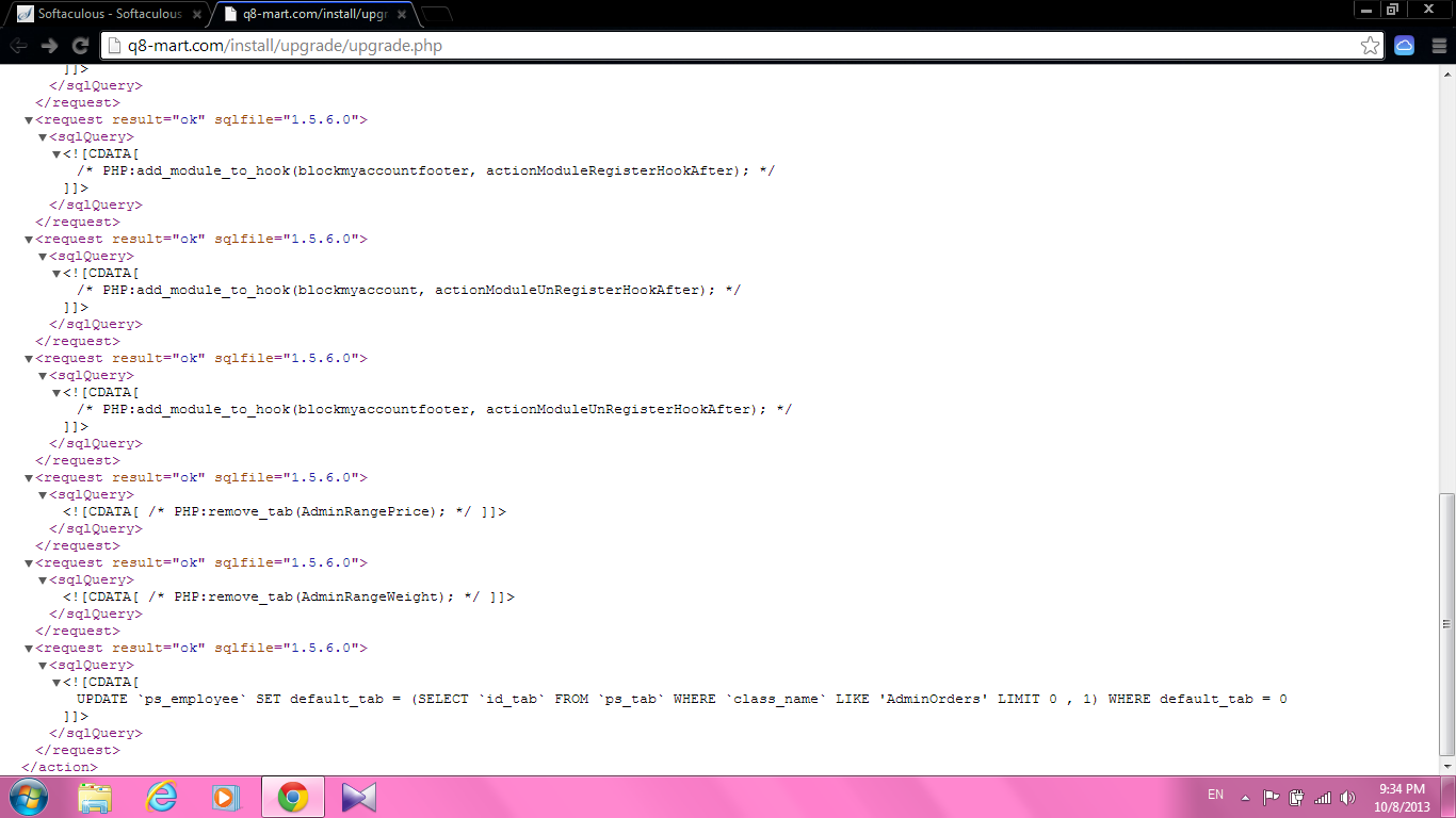

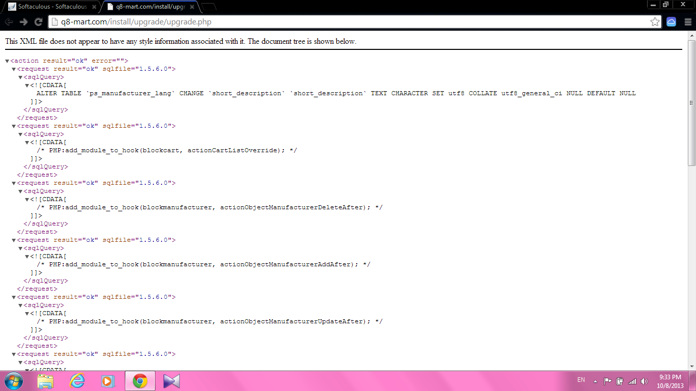

suteibi Posted October 8, 2013 Share Posted October 8, 2013 HI, i received an email to upgrade my PS version to 1.5.6.0, i followed the instructions exactly by logging into my cPanel and do the necessary upgrade (i also took a backup), when i finished the upgrade, it said " Please visit below link to complete the upgrade process. http://q8-mart.com/install/upgrade/upgrade.php " i did click on this link and got the attached screen shot, also when i tried to log in to my PS, i got a message saying that for security reasons, i cant log in to PS, and there is something was deleted. please assist me since i cant log in to my PS any more. please find the other attachments as well this is what i get when i click the link i mentioned : This XML file does not appear to have any style information associated with it. The document tree is shown below. <action result="ok" error=""> <request result="ok" sqlfile="1.5.6.0"> <sqlQuery> <![CDATA[ ALTER TABLE `ps_manufacturer_lang` CHANGE `short_description` `short_description` TEXT CHARACTER SET utf8 COLLATE utf8_general_ci NULL DEFAULT NULL ]]> </sqlQuery> </request> <request result="ok" sqlfile="1.5.6.0"> <sqlQuery> <![CDATA[ /* PHP:add_module_to_hook(blockcart, actionCartListOverride); */ ]]> </sqlQuery> </request> <request result="ok" sqlfile="1.5.6.0"> <sqlQuery> <![CDATA[ /* PHP:add_module_to_hook(blockmanufacturer, actionObjectManufacturerDeleteAfter); */ ]]> </sqlQuery> </request> <request result="ok" sqlfile="1.5.6.0"> <sqlQuery> <![CDATA[ /* PHP:add_module_to_hook(blockmanufacturer, actionObjectManufacturerAddAfter); */ ]]> </sqlQuery> </request> <request result="ok" sqlfile="1.5.6.0"> <sqlQuery> <![CDATA[ /* PHP:add_module_to_hook(blockmanufacturer, actionObjectManufacturerUpdateAfter); */ ]]> </sqlQuery> </request> <request result="ok" sqlfile="1.5.6.0"> <sqlQuery> <![CDATA[ /* PHP:add_module_to_hook(blocksupplier, actionObjectSupplierDeleteAfter); */ ]]> </sqlQuery> </request> <request result="ok" sqlfile="1.5.6.0"> <sqlQuery> <![CDATA[ /* PHP:add_module_to_hook(blocksupplier, actionObjectSupplierAddAfter); */ ]]> </sqlQuery> </request> <request result="ok" sqlfile="1.5.6.0"> <sqlQuery> <![CDATA[ /* PHP:add_module_to_hook(blocksupplier, actionObjectSupplierUpdateAfter); */ ]]> </sqlQuery> </request> <request result="ok" sqlfile="1.5.6.0"> <sqlQuery> <![CDATA[ /* PHP:add_module_to_hook(blockmyaccount, actionModuleRegisterHookAfter); */ ]]> </sqlQuery> </request> <request result="ok" sqlfile="1.5.6.0"> <sqlQuery> <![CDATA[ /* PHP:add_module_to_hook(blockmyaccountfooter, actionModuleRegisterHookAfter); */ ]]> </sqlQuery> </request> <request result="ok" sqlfile="1.5.6.0"> <sqlQuery> <![CDATA[ /* PHP:add_module_to_hook(blockmyaccount, actionModuleUnRegisterHookAfter); */ ]]> </sqlQuery> </request> <request result="ok" sqlfile="1.5.6.0"> <sqlQuery> <![CDATA[ /* PHP:add_module_to_hook(blockmyaccountfooter, actionModuleUnRegisterHookAfter); */ ]]> </sqlQuery> </request> <request result="ok" sqlfile="1.5.6.0"> <sqlQuery> <![CDATA[ /* PHP:remove_tab(AdminRangePrice); */ ]]> </sqlQuery> </request> <request result="ok" sqlfile="1.5.6.0"> <sqlQuery> <![CDATA[ /* PHP:remove_tab(AdminRangeWeight); */ ]]> </sqlQuery> </request> <request result="ok" sqlfile="1.5.6.0"> <sqlQuery> <![CDATA[ UPDATE `ps_employee` SET default_tab = (SELECT `id_tab` FROM `ps_tab` WHERE `class_name` LIKE 'AdminOrders' LIMIT 0 , 1) WHERE default_tab = 0 ]]> </sqlQuery> </request> </action> thank you Link to comment Share on other sites More sharing options...

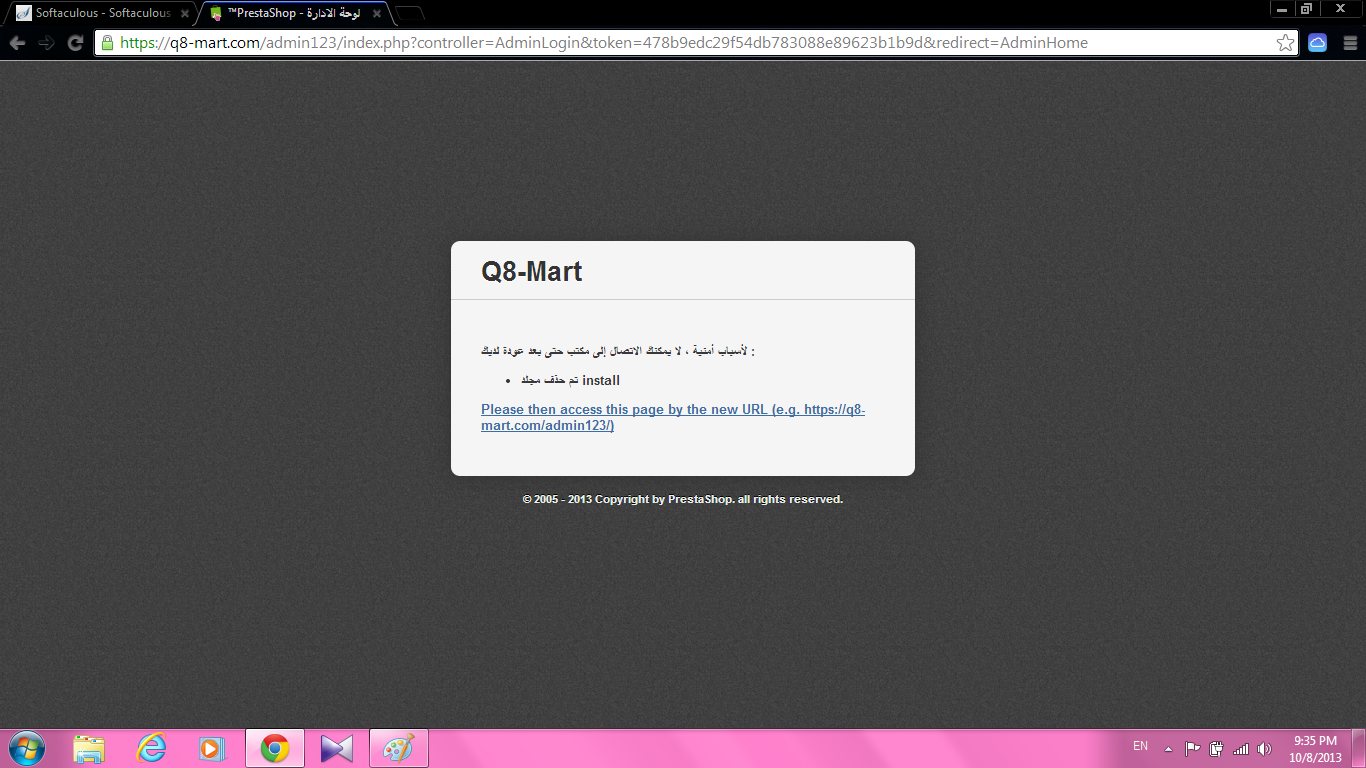

suteibi Posted October 8, 2013 Author Share Posted October 8, 2013 i restored both, and the restore went fine, and i saw that the version changed back to 1.5.5.0 on "all installation" in softaculous, then i tried to log in to my PS, i got the a message saying that for security reasons, i cant log in to PS, and the install folder was deleted. Q8-Mart لأسباب أمنية ، لا يمكنك الاتصال إلى مكتب حتى بعد عودة لديك : تم حذف مجلد install Please then access this page by the new URL (e.g. https://q8-mart.com/admin123/) © 2005 - 2013 Copyright by PrestaShop. all rights reserved. you can us Google translate to translate from Arabic to English Link to comment Share on other sites More sharing options...
