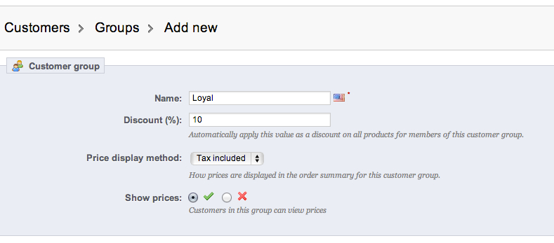

Make a group "Loyal". Add any discount you want to give to the group
save the group and check the ID number of the new group:
Remember this ID number, as we need to use is soon.

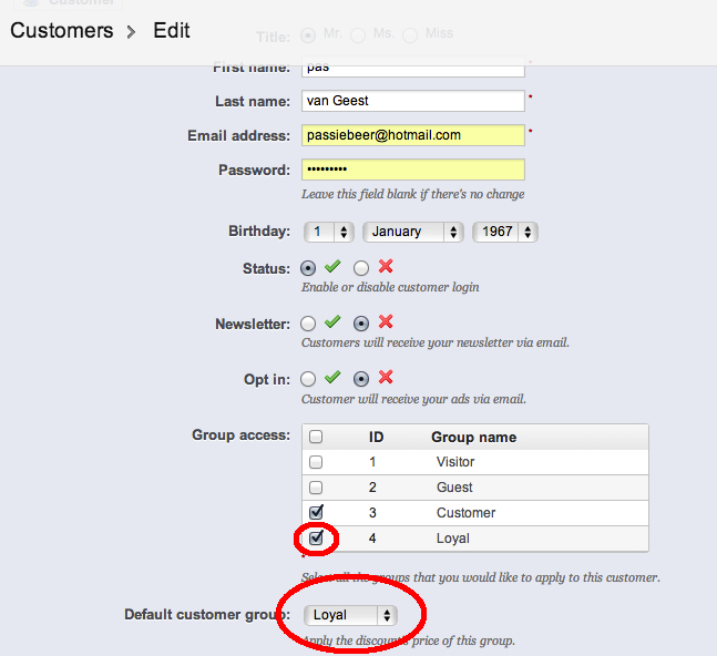

Then prepare a test customer (login as a new customer if you don't have one):
Edit the customer and put the customer in de 'Loyal' group AND set default group to "Loyal"

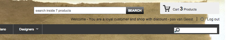

- if the customer is logged in, it checks if it is a "loyalcustomer". If so, it prints the sentence you wanted in the top header, next to the customer name. If not, it doesn't print this.
- The <span> around the text gives the possibility to add some css code to it (to make it bold, give it a background colour, change the font, etc. etc.).
- The {l s='<our text>'} gives the possibility to change the text in the Back office (Then go to Localization->translation, Installed Modules Translation, BlockUserinfo translations to do this)
All done?
Now reload your front page  (Ctrl-F5), login as the loyal customer your prepared and see if it works.
