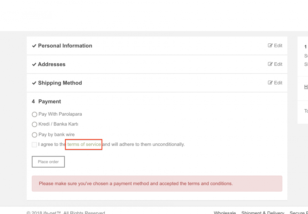

ifs-net Posted January 29, 2024 Share Posted January 29, 2024 Hello, How can I add some variables to sales terms page pls ? I mean at the page that opens when you click sales terms. I want to add customer name , adress etc at terms page. Link to comment Share on other sites More sharing options...
