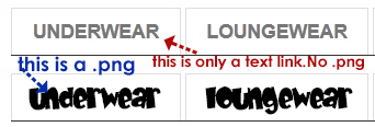

trent Posted October 4, 2013 Share Posted October 4, 2013 Hello, you can replace a menu link 'text with an image link?I mean, let's say that the menu item 'is "logan", i can replace the text logan, with a gif or png with the inscription logan? I hope I explained Thanks! Link to comment Share on other sites More sharing options...
NemoPS Posted October 5, 2013 Share Posted October 5, 2013 Hi! Can you perhaps show us a visual example? I have to be honest, I didn't quite get what you are referring to! Link to comment Share on other sites More sharing options...
trent Posted October 5, 2013 Author Share Posted October 5, 2013 (edited) Hi! Can you perhaps show us a visual example? I have to be honest, I didn't quite get what you are referring to! :) In attachment a visual example hope this is more clear aha Edited October 5, 2013 by trent (see edit history) Link to comment Share on other sites More sharing options...
NemoPS Posted October 5, 2013 Share Posted October 5, 2013 That depends on your theme, can you show us the real site perhaps? Link to comment Share on other sites More sharing options...
trent Posted October 5, 2013 Author Share Posted October 5, 2013 That depends on your theme, can you show us the real site perhaps? This is the site: http://livedemo00.template-help.com/prestashop_36663/ Link to comment Share on other sites More sharing options...
NemoPS Posted October 5, 2013 Share Posted October 5, 2013 Unless you use javascript, no, you can't At leaset, I've never seen this functionality in the tmcategories module Link to comment Share on other sites More sharing options...
trent Posted October 5, 2013 Author Share Posted October 5, 2013 Unless you use javascript, no, you can't At leaset, I've never seen this functionality in the tmcategories module I have seen a site like this where instead the change had been made. From the code I've seen, it seems that the change (hook) has been made with: {if ($node.item=='child')} <li class="{if isset($last) && $last == 'true'} last{/if}"> <a href="{$node.link}" {if isset($currentCategoryId) && ($node.id == $currentCategoryId)}class="selected"{/if}> {$node.name|escape:html:'UTF-8'} </a> {else} <li class="{if $node.children|@count > 0}sub{/if}{if isset($last) && $last == 'true'} last{/if}"> <a href="{$node.link}" {if isset($currentCategoryId) && ($node.id == $currentCategoryId)}class="selected"{/if}> {if !($node.id==2)&&!($node.id==9)&&!($node.id==10)&&!($node.id==11)&&!($node.id==12)&&!($node.id==13)&&!($node.id==14)&&!($node.id==16)} {$node.name|escape:html:'UTF-8'} {else} {if ($node.id == $currentCategoryId)} <IMG SRC="./themes/mytheme/img/menu/{$node.name}-roll.png" align="bottom"> {else} <IMG SRC="./themes/mytheme/img/menu/{$node.name}-on.png" align="bottom" onmouseover='this.src = "./themes/mytheme/img/menu/{$node.name}-roll.png";' onmouseout="this.src='./themes/mytheme/img/menu/{$node.name}-on.png';"> {/if} Link to comment Share on other sites More sharing options...
