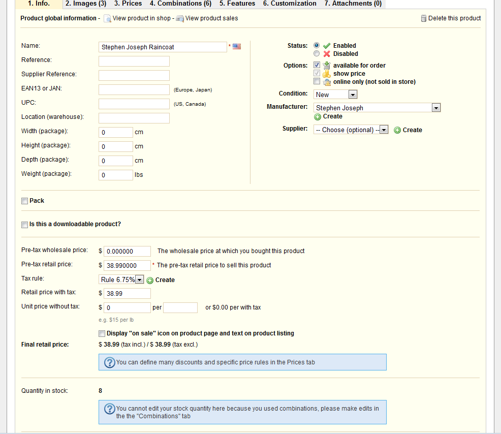

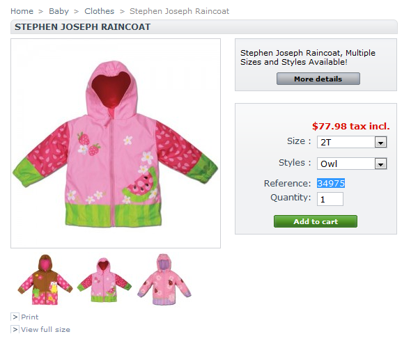

christophernewman24 Posted October 3, 2013 Share Posted October 3, 2013 We are experiencing a problem on our site. Items that have combinations are showing up on the frontend and the backend with double the retail price. However when you go to the modify edit form of the item the retail price is the correct amount price, half. Here is an example product. In the backend the item is really $38.99 images attached. Please help us with this. Thanks in advance. Link to comment Share on other sites More sharing options...

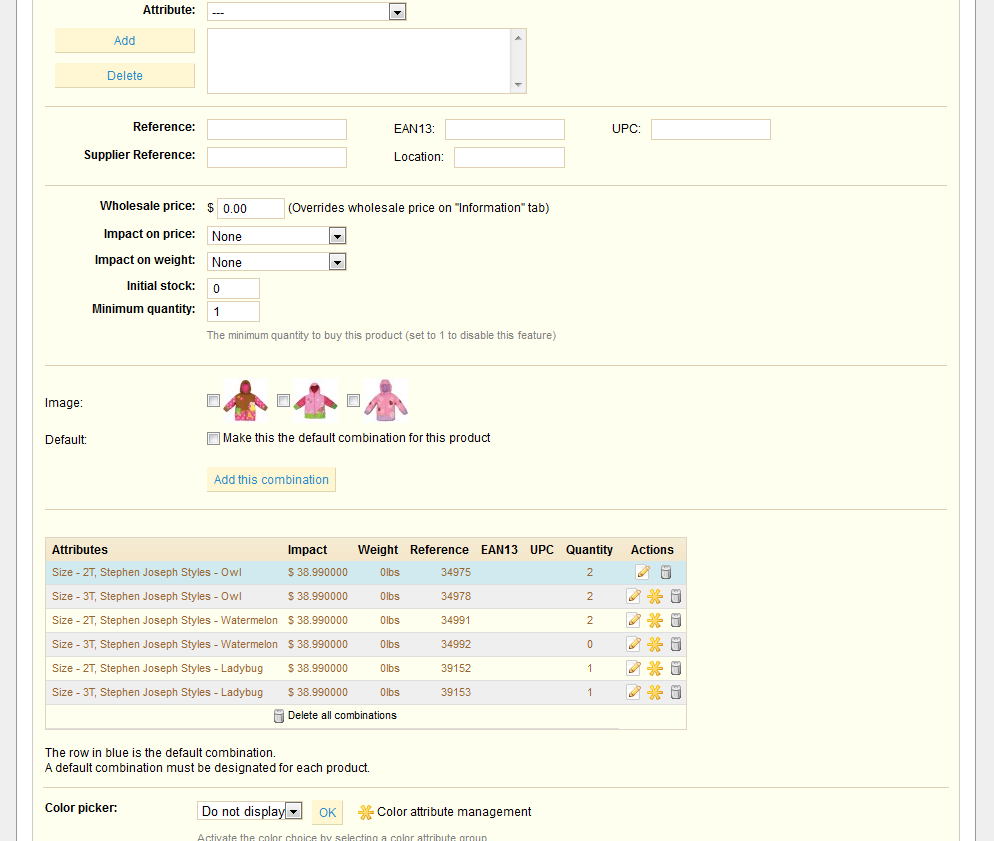

Carolina Custom Designs Posted October 3, 2013 Share Posted October 3, 2013 Yes but what is the price of the 'Owl 2T'? That is the combination that is showing on the product page. Marty Shue Link to comment Share on other sites More sharing options...
christophernewman24 Posted October 3, 2013 Author Share Posted October 3, 2013 (edited) each of the combinations are the same price. For some reason the price on the frontend is double. you can view the issue on our site here. http://www.pillboxamelia.com/store/product.php?id_product=6170 Edited October 3, 2013 by christophernewman24 (see edit history) Link to comment Share on other sites More sharing options...
Carolina Custom Designs Posted October 3, 2013 Share Posted October 3, 2013 each of the combinations are the same price. For some reason the price on the frontend is double. That is precisely why the price on the FO is doubled. You have the default price at $38.99 and the combination set to $38.99. This will double the price in the FO. You should make the combinations what you want the price to increase to. Marty Shue Link to comment Share on other sites More sharing options...
