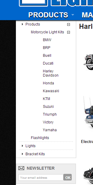

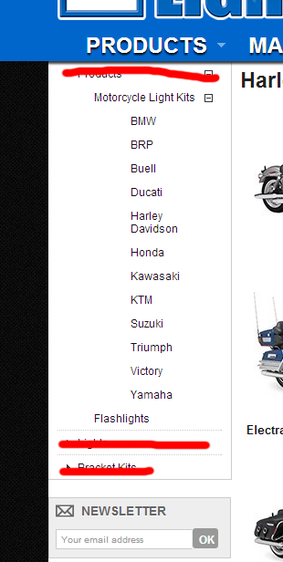

sure, i'll attach a couple screen shots. the first one shows it as-is, the second one shows what i want to get rid of. pretty much, i want to hide all the root categories and only show the sub categories from the "products" category. everything we sell will be in there. i want to use the other root categories ("Lights" and "Bracket kits") for sorting items that we do not sell on their own, but in packs.
for example, we have four models of lights, but we don't sell the lights on their own. each "kit" that we sell comes with a bracket for your specific motorcycle, the light type you choose and the hardware needed to install on your bike.
so i'm building "packs" that will automatically assemble all the different parts into one product that you can buy.
each "pack" component has to have a category, even though we don't sell the components individually.
does this make sense? i know it's kind of complicated.

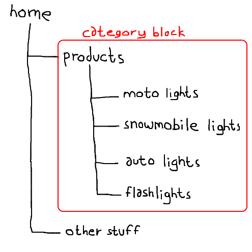

pretty much, i just want to display one category and it's sub categories in my category block, like the attached picture.
